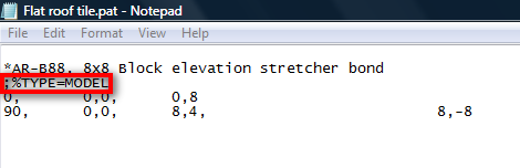

Very much appreciated my friend. I'm on the run but I'll check it out first thing in the morning. The dialog you said to add to the autocad .pat files, where in the file does that go? Probably obvious when I open it up but, I thought I'd ask while I'm posting anyway.

You're welcome Phil....you have to add it after the pattern name (see image), but save it under another name , if not, it won't work anymore with ACAD...BTW, I visited your site, nice projects, let me say......

Finally got to try you.pat file and I must be doing something wrong. I had to change the dialog to drafting to get it to accept it but when done I had a blank area.
