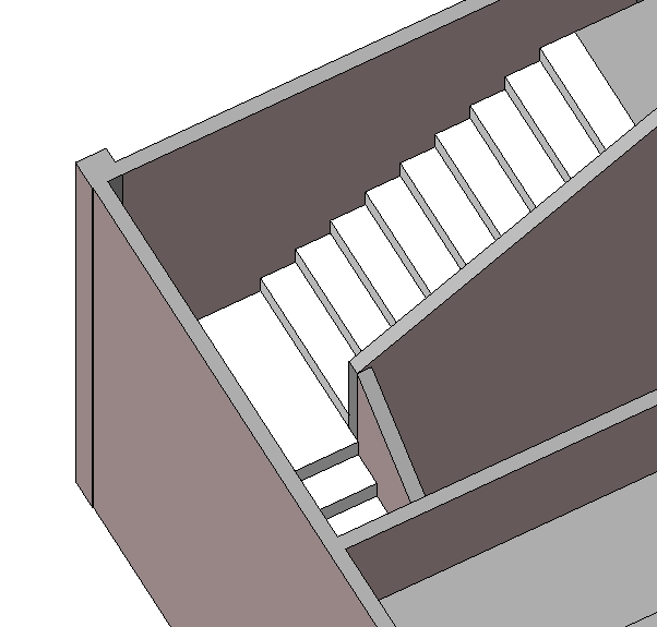

My question is, is it possible to 'host' handrails to walls??
I have a set of stairs (as pic attached) and i want to attach some rails on the internal sloping walls. I cant seem to 'host' them onto the walls itself, only to the stairs and then play around with offsets etc. Unfortunately, these walls are in place already and the walls are not parrallel with the stairs so it dont work too well.
any ideas or help please!?

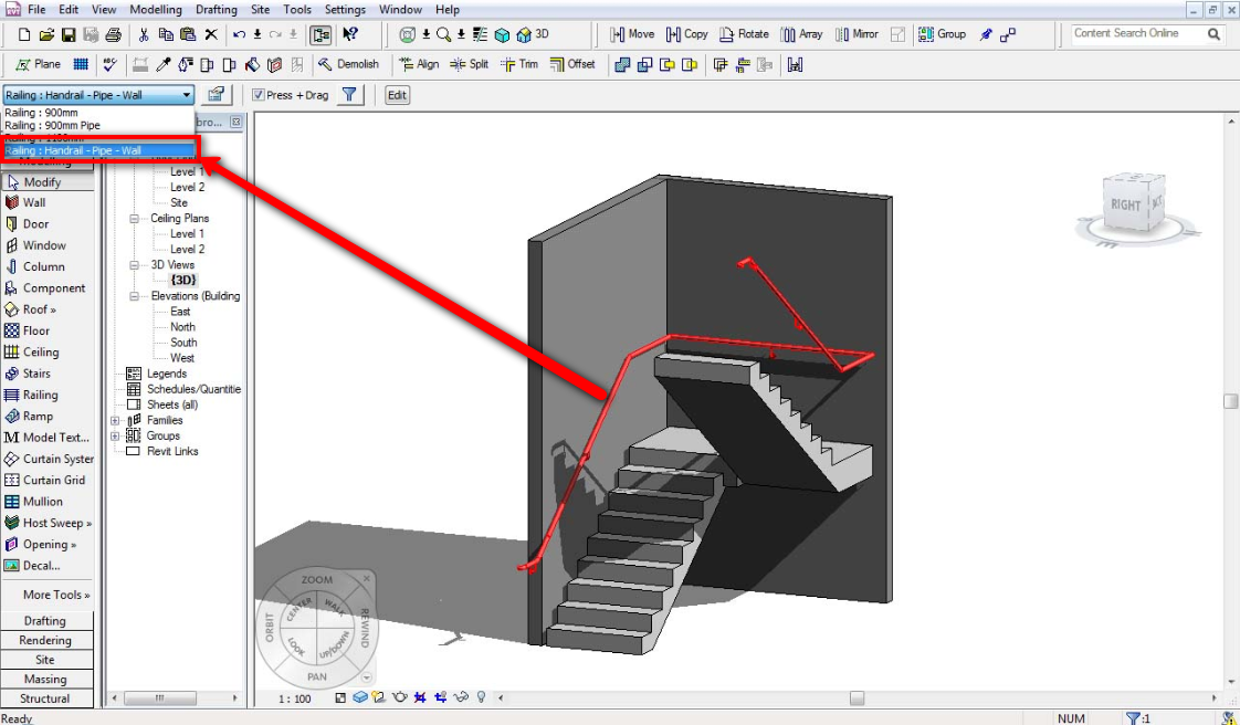

Hi latino76, of course you can....try with this one (attached).....what you have to do is copy-paste this handrail into your project, pick your existing handrail and change to this one...

You can also edit the stair boundaries so that they are parallel to the wall.  The rails should then be parallel also.
Wed, Mar 25, 2009 at 7:15:45 AM | Attaching Rails to walls
Actually, the handrail erland73 shows is not wall hosted, it only appears to be.  The handrail is still hosted by the stairs but the sketch for the handrail is sketched parallel to the wall.
You can find examples of several rail styles in the on-line library and you can copy-clip these into your project.
