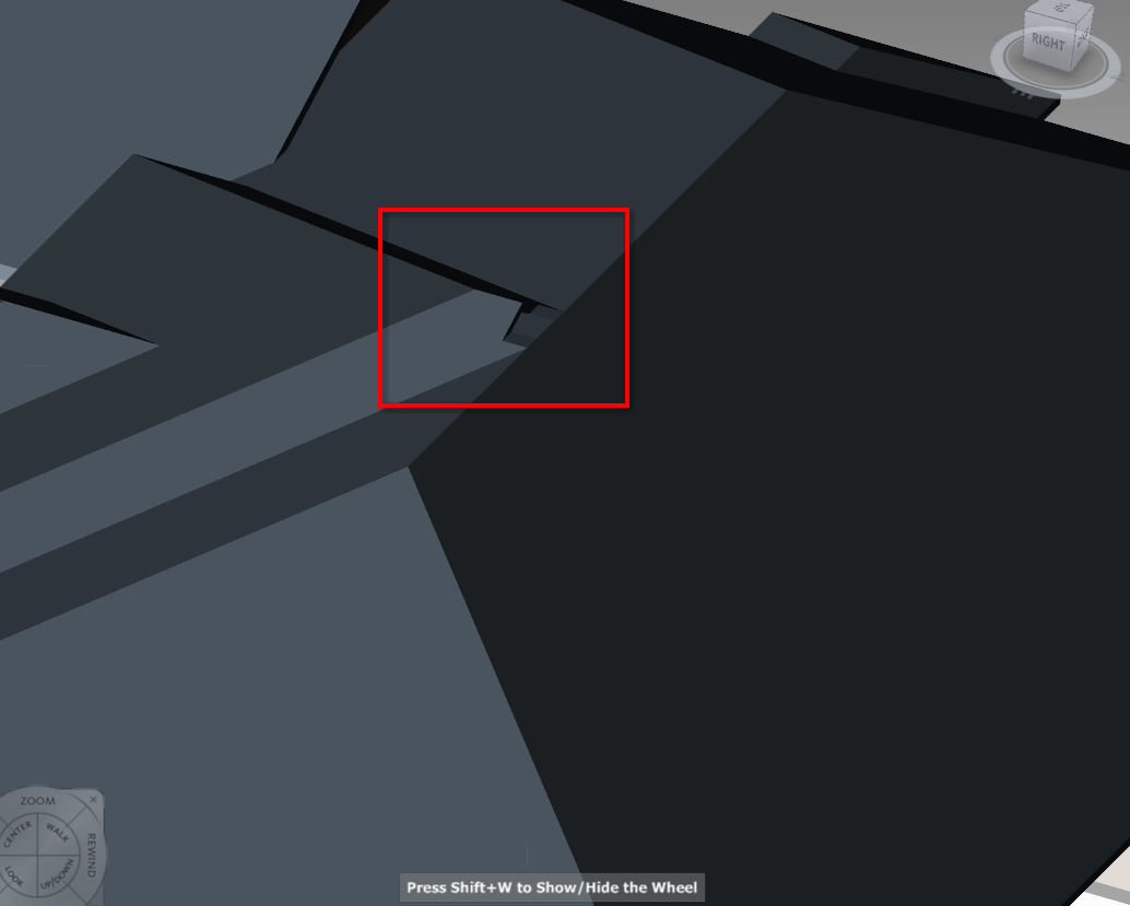

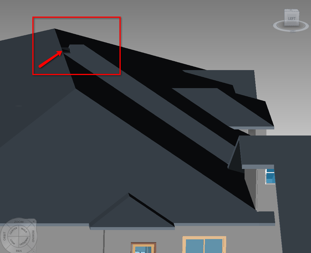

The problem with the "join/Unjoin roof" is here like yyou can see in the images attached...

Ya, That's an area that  I haven't gotten into fixing yet but I drew it correctly in the roof plan using detail lines. I have a little tutorial about adding that missing peice but haven't dug into it yet. This is my first project since switching from ACA and I'm just taking it one step at a time. I have been advised in other forums though, that the join/unjoin roof command is probably causing the problem. Thank You for your input and I will look into it.
