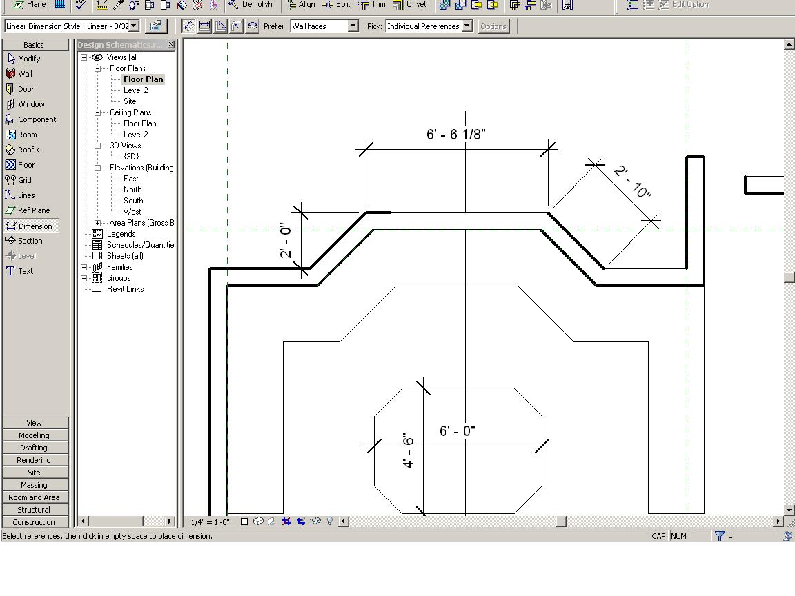

Anyone has an idea why I am not able to dimension an angled wall, see screen shot. You will see that I was able to dimension the wall on the right but the left side is giving me problems, I keep cycling thru to select the right wall points as I did with the wall on the right but no success.

Cycle through two times to get the point on the corner and it should dimension.  The first time it will select the point that is orthagonal, the second time it selects the point aligned to the wall.

Got it thank so much Tim123
