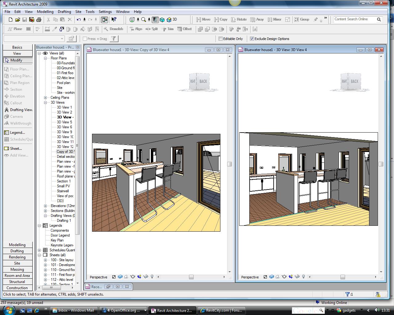

Hi everyone
I have a problem regards with the  camera because as i take a shots and streching the box the displayed lines  were  distorted and   it is  not good for perspective

Move your camera back - you may need to hide elements to do this.  Stretching the box is like creatin a wider angle lens and will distort the perpective.

As soon as you start stretching the box the perspective is distorting although a small amount wont make much difference.  Compare the two views - the left hand image shows the camera much too close and is distorting the perspective.

I see there is a quite difference but is there a way that we can eliminate those distorted lines? or do we have other option or method so that we can create great perspective without distorted lines
