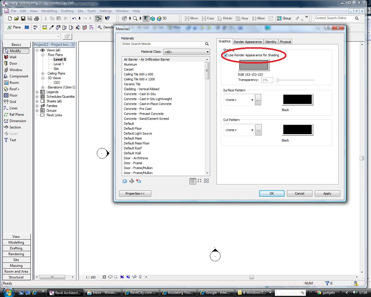

Also, I don't know much about the rendering aspect of Revit... coming from just knowing CAD I think the 3D views are pretty cool but is it only in Rendering that I see all of the textures because I feel like I go in and change the render appearence to something really cool and it still looks the same in 3D...

To get the rendering right takes experimenting with the different settings to see what happens - keep trying.  To get the 3D view to display the material changese make sure the 'Use render appearance for shading' box is checked - see image.
