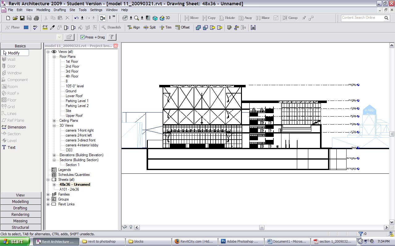

i am having this exact problem right now in Revit 2009. Basically, in the section view, I have a whole bunch of things hidden (i.e., people and cars) But when i put the section view on a sheet layout, and i print that sheet layout, those hidden things appear!
 in addition, I edited the level lines in teh section view but when i print it, it goes back to the old  way the level lines were. im attaching 2 images for u guys to see the problem, one has the section as it appears on my screen, which is how i want it to print and the other is how it actually prints (prints incorrectly)

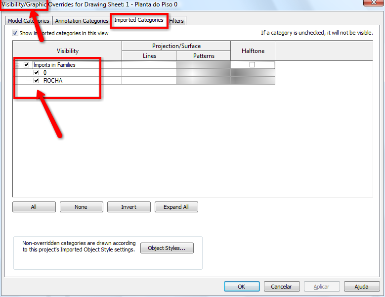

Those object in the back of the image are "Masses"??? If so, did you try in VG uncheck the visibility???

VG= Visibility/Graphic, so if those objects are from Rhino so in VG/Imported Categories turn off those "Layers"...
About the mass, export the mass in SAT File (ACIS Solid) not in MESH, then when you import to Revit you can apply Walls, roof, Floor by face and surtains systems in that ACIS solids...

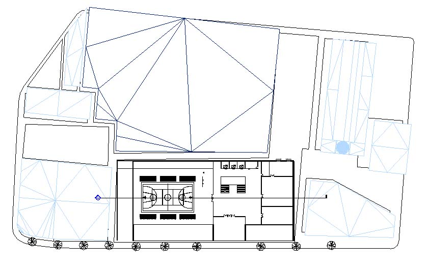

thakns for the quick reply. actually i exported from rhino to 3dsmax (since i dont know rhino), and then from 3dsmax to Revit. given that it is actually coming from 3dsmax, do u know how i can get rid of those jagged blue lines on the imported bldgs? if i can do that i wont have to make new masses in revit.
 drawing is attachced

but i like the idea of what u r suggesting to me, because some of the buildings are kind of compilicated (i.e. the one of the fancy historic church, st. vibianas, in upper right) and it would be smarter to simply import the bldgs from rhino and then add walls or floors so taht we dont see the jagged blue lines which r ugly and annoying
