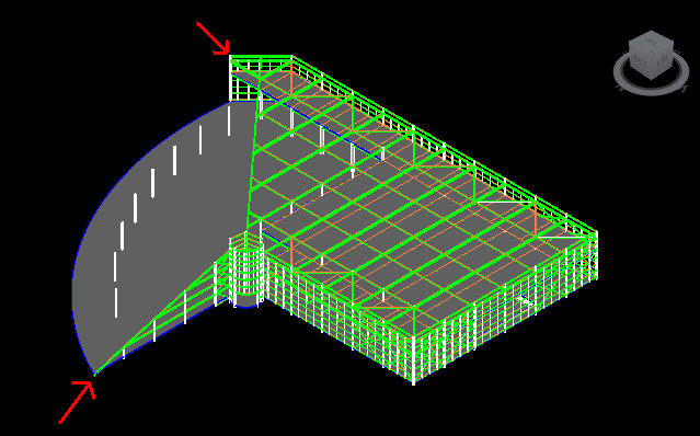

I have no idea how to put into words this problem, basically i am trying to put a sloped curved beam in between two defined points, and cannot think how to do it, ive attached a jpeg of the 3d to show the points i wish to connect! any help would be greatly received!

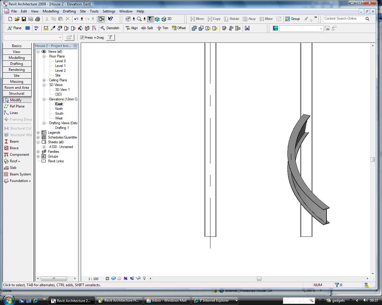

The attached image shows an in place structural component created with a curved sweep and a loaded profile.  Is this what you are trying to achieve?

After I created the curved beam I unlocked it (edit the family and click on the beam - it has a padlock on that prevents it from rotating).  It can then be rotated.

no..... i have managed to do it but it still doesnt look right as it wants to twist.  I created a sloping ref plane between the 2 points i wanted then on plan drw the curved beam to that ref plane, thus creating the curved slope i wanted but it has a twist on the steell....

The beam would indeed be twisted.  To create the beam in real life it would have to be twisted.  You can create the twist in the beam to correct this by using the swept blend tool using the same profile rotated to the relevant angle at each end.
