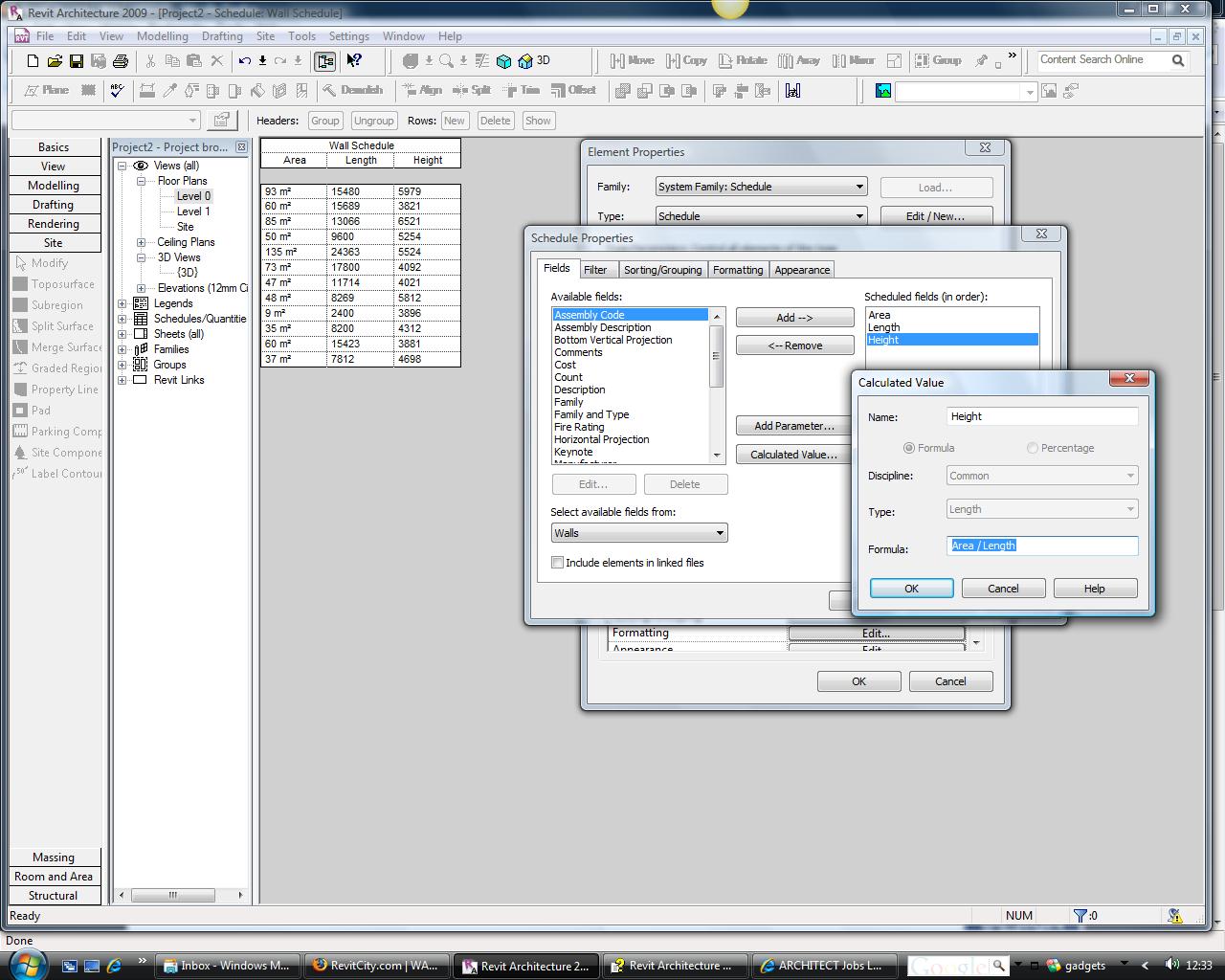

I need to show the wall height on the wall schedule, so far, i have not found anything where explains how to do so.
 Is it possible to show the wall height on the wall schedule?
Thanks

The wall height often varies, but you can get the average height by adding a parameter to calculate it.
