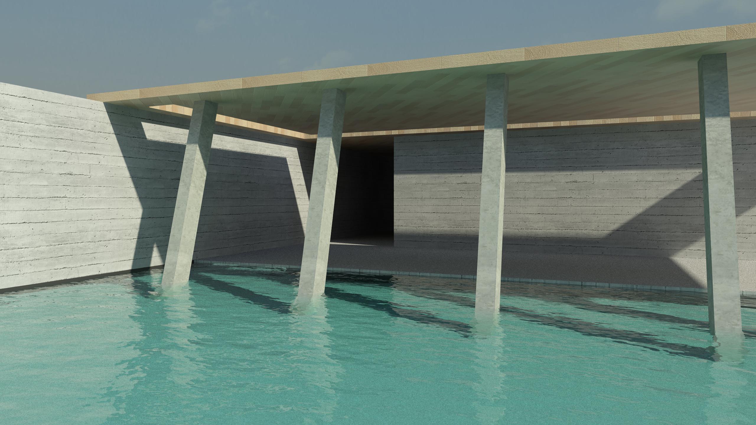

I'm not sure why you would want to do this.  I create a thin floor type with water properties which gives the impression of water all the way to the bottom in 3d views.  If it is for a section then a filled region may be easier than modeling it.

See image.

If its for a rendered section then you will need to model it.

nice render
u made the water look really good

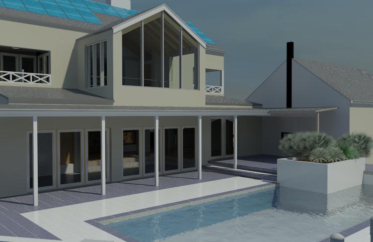

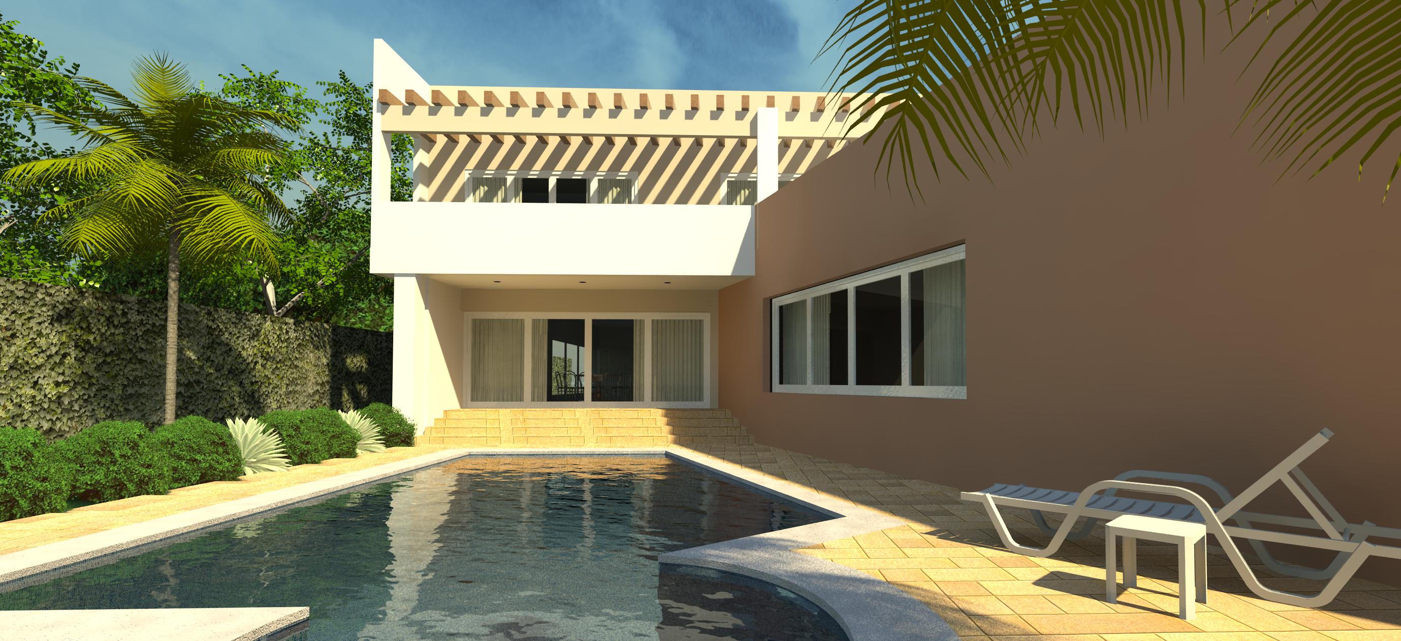

Hi jdivina, I agree with Typhoon and tim123 about using a floor as your water surface so you'll be able to change its thickness whenever you want for your section....I did it that way in my model (see image), and worked perfectly....

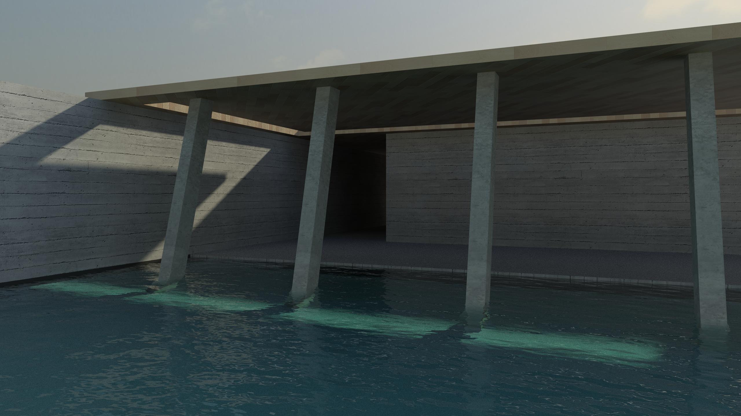

Anybody know how to make the water transparent so I can see through it when I render?  In the example picture, I would like to be able to see the bottom part of the column that extends into the water and not just it's reflection on the surface.

Actually, I've been looking at my renders and now I am wondering if it is actually doing what I want it to do.  It is very hard to see and be able to tell.
Here is another render, is the water transparent?

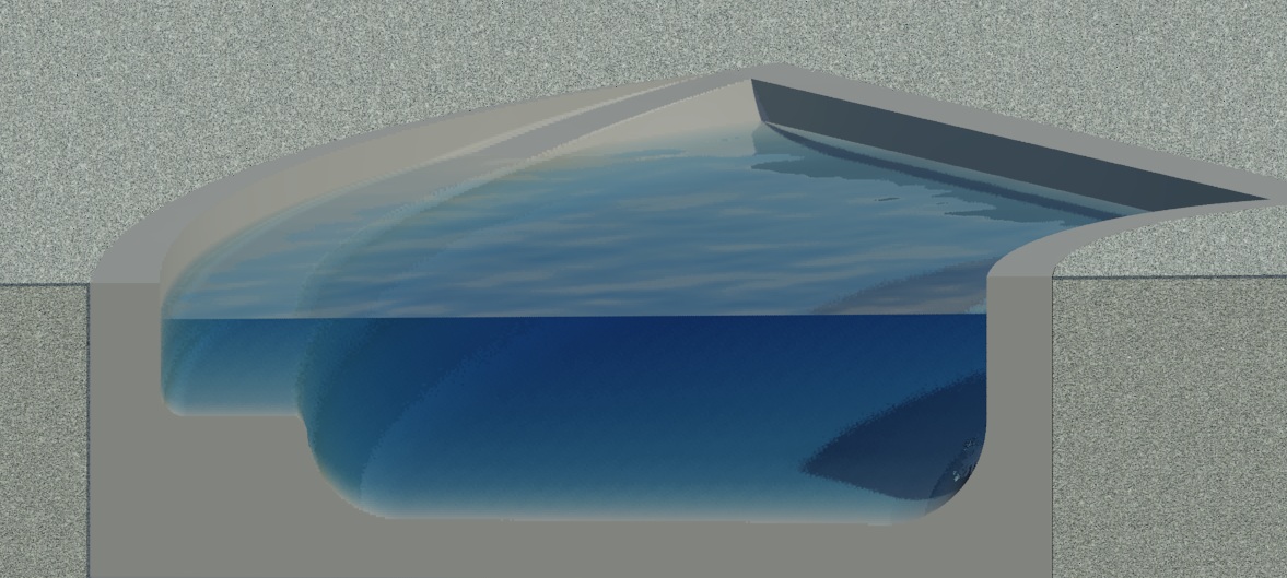

well... if you use the massing tools to build the pool itself, you could then copy the mass' family, open it up, switch all the geometry to void forms, and use those voids to cut a mass you make as the water.  superimpose the two families, and now they're seamless as pool, and pool water.

proof of concept for the above idea.  Oooo, the deep blue.

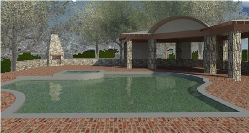

I am working in 2011 and rendering water.  However my swimming pool water looks no where near as good as what you have posted.  I keep changing settings but looks pretty bad no matter what.  See attached.  What settings do you use to make it look so good?
