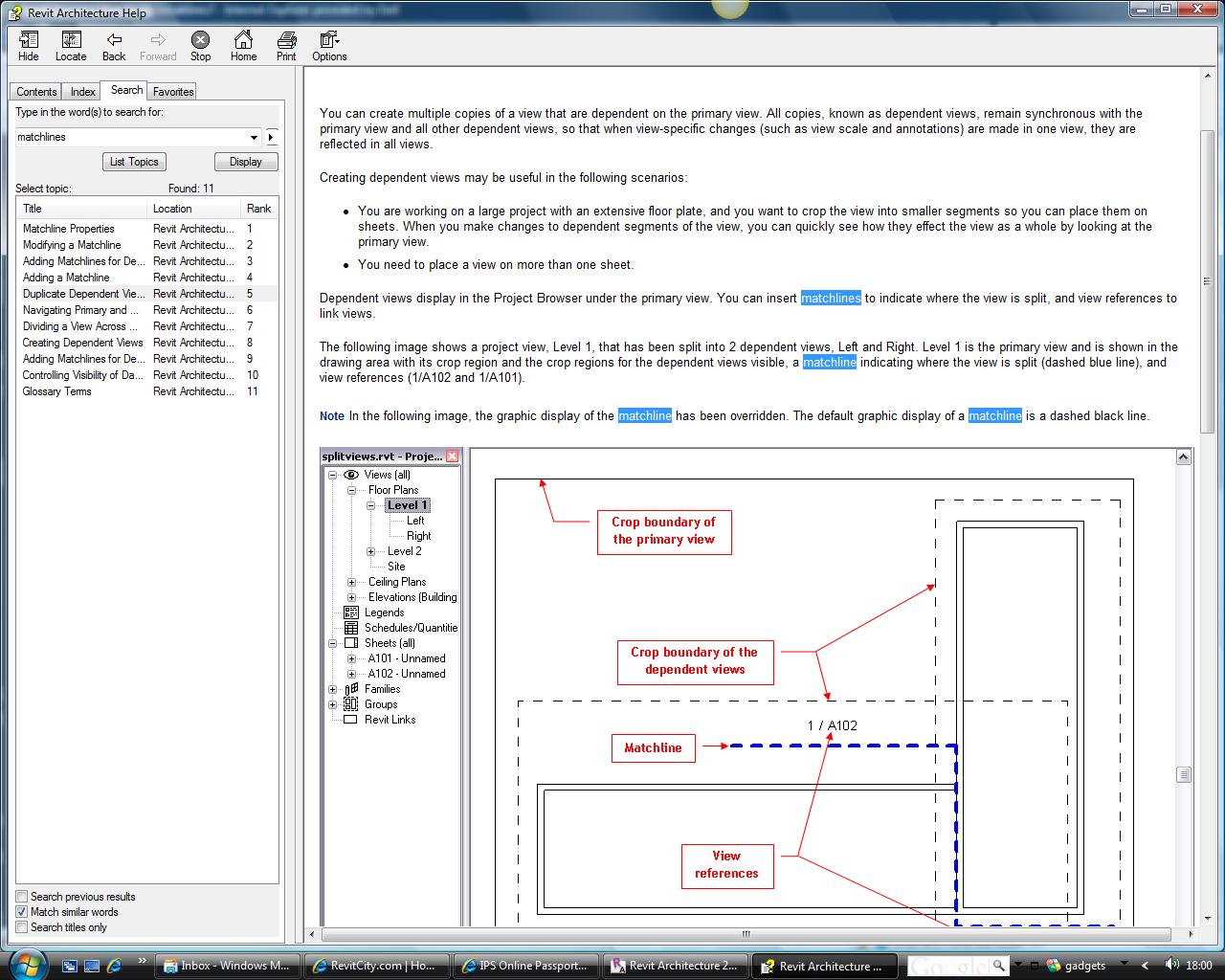

Matchlines work with dependant views.  Look at the help under 'Duplicate dependant views'.
