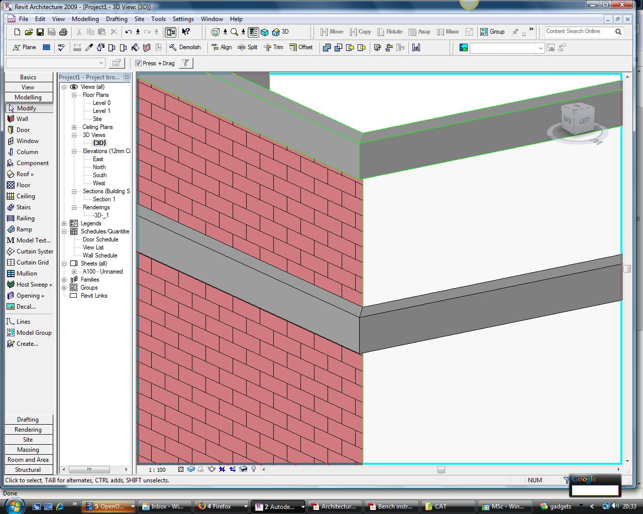

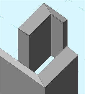

I have 2 different sized walls on 5" one 8" I have made wall sweeps profiles of each size and attache them to the wall tops.
I need them to miter / angle at the pionts where they meet.
I have tried puting the profile into the wall structure as a sweep and as a host sweep. no success either way.
The attached image shows the results I am getting. I need it to look like the top one minus the "wings"
 I am using revit 2008
 Any ideas?

I'm trying to replicate your problem but am unable to.  The image shows two different types of walls with different thicknesses with sweeps that are slanted.  The top sweep is in the wall and the lower one is a host sweep.  Are you sure that the sweeps are at the same level and that the profile is the same for both?

The problem is the sweeps are not the same for both.
One is 8" and one is 5".
I am trying to get 2 different wall widths with 2 different profiles to miter at a corner

I don't think that you will be able to get them to mitre.  You will need to model them.

ok I can work with that. Model them how?
I would like to just make corner peices. Any ideas on how?
I cant figure that out either
thanks!!

OK I got it.
I made the a 5" angled top extrusion while I was making the extrusion I added a void for the mitered end.
I did the same thing for the 8" wall.

Yes. that is what I would have done.
