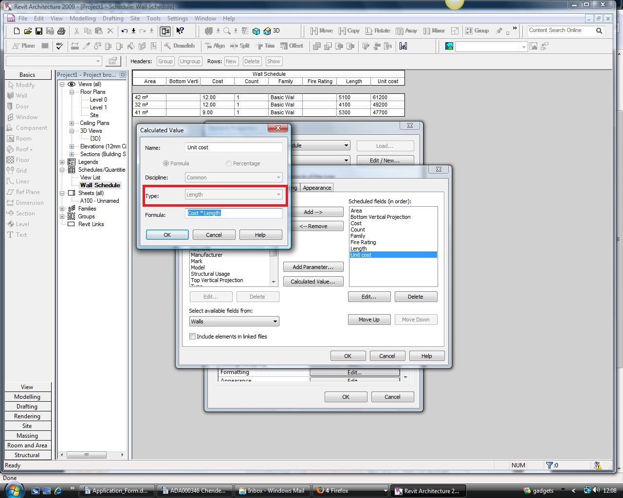

As Revit suggests, the units are inconsistent.  Length * number = length, so the units need to be set to length, not number for this to work.

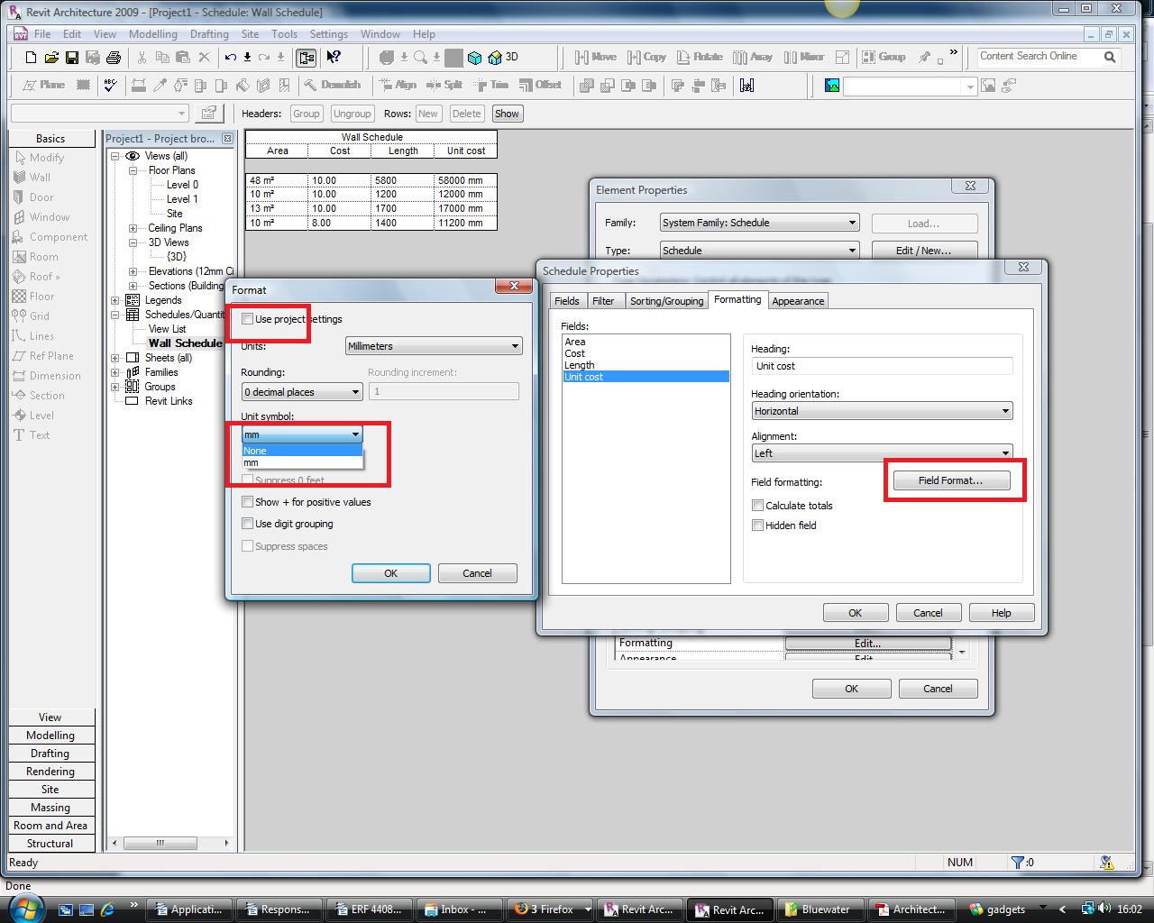

Under formatting go to Field Format and override the project settings.
