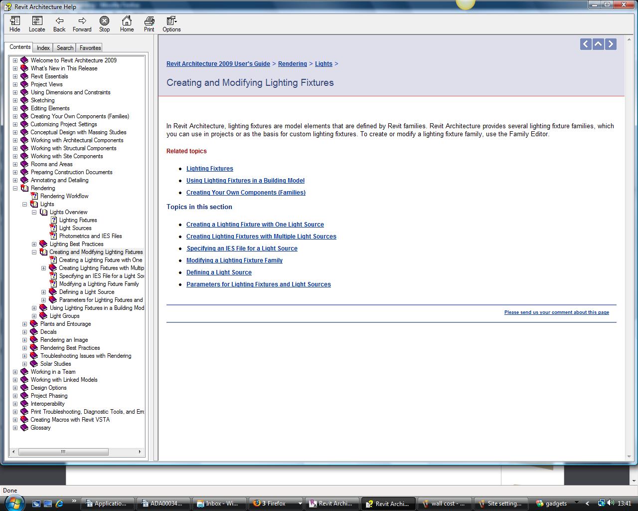

You can load lights from the library, or create your own.  Help explains how to do this - see image.

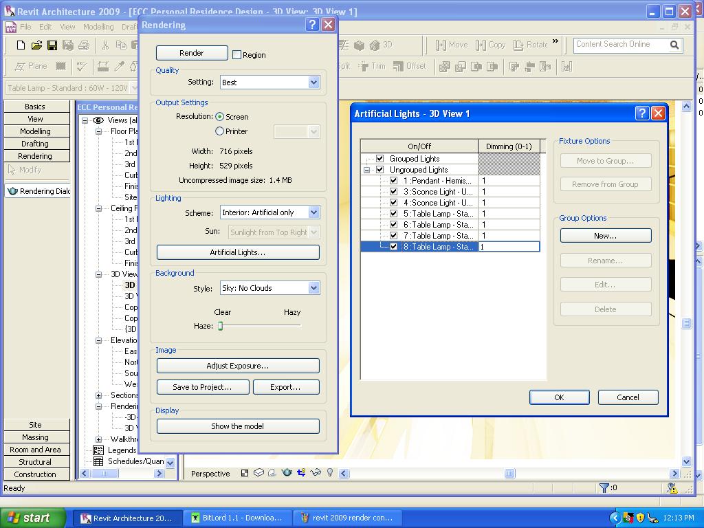

Insert a lamp or wall sconce or any artificial light source in your model.  The rendering menu asks you which lights you want to turn on/off and how you want to group them.  Set your "scheme" to interior: artificial lights.
