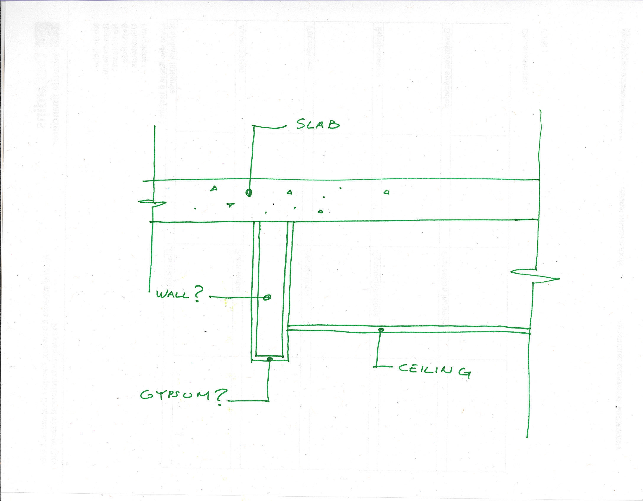

Hi, I am trying to draw a ceiling. See attached Image. I think I should draw a small wall. Is there a way to get gypsum under the wall?
Thanks!
Math.

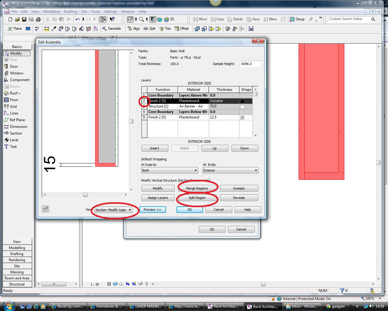

You can edit the wall properties to show this.  Go to the wall properties and edit the structure.  Click on the preview button and set the view to section view.  Click on Split Region and draw a line where the gypsum will end.  Click on merge regions and higlight the boundary between the vertical and horizontal gypsum.  Move the gupsum layer into the core .

Ditto tim123,
i would move the other gypsum layer into the core also
also i would duplicate and name this wall type so that it is not mistaken to be used in a standard type wall usage

Yeah, good point, this modification will apply to all walls of this type.
