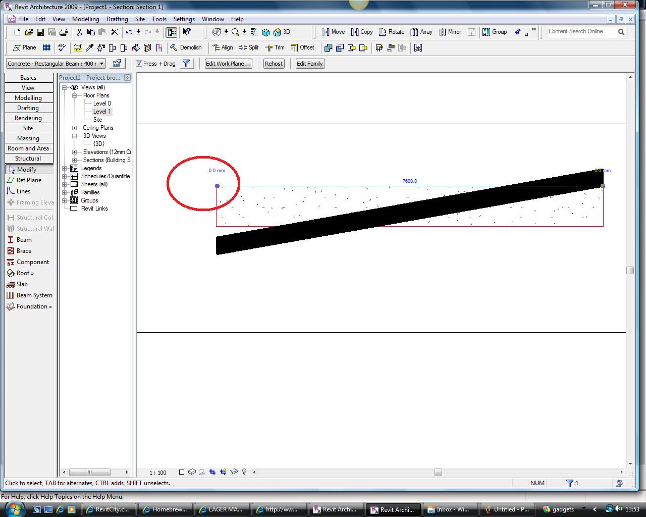

I am creating an underground multistorey carpark with a series of sloping levels. Is there anyway to attach concrete beams to the underside of the ramps and floors so these beams sit at the levls of these elements accuratly reflecting the height difference along the beam length?

You cannot get the beams to automatically attach to the u/s of floors, but it is quite easy to adjust the beams in section - see image.  Click on the beam and adjust the elevation at each end.
