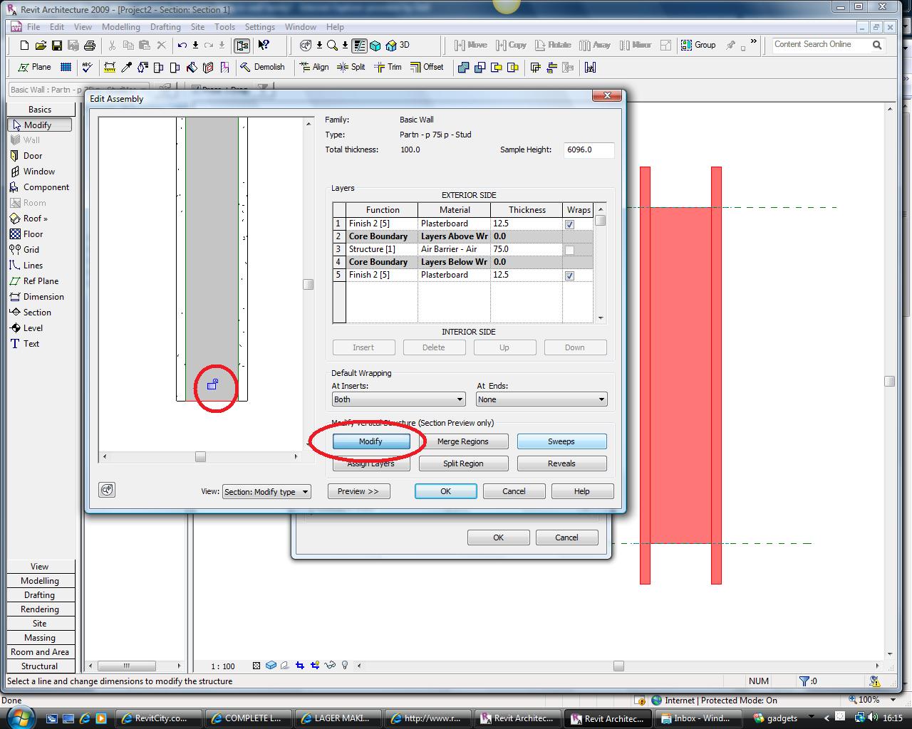

I'm trying to create a family for wood shear walls.  I've figured out how to add the sheathing (easy), but I can't figure out how to add top & bottom plates to my wall family.  Is there an easy way to do this?  It seems like there should be a simple way to extrude a few 2x plates inside the wall family & constrain them to the top & bottom of the wall... no?  I just can't figure out how to modify the wall families to do this.
Any help would be much appreciated.  It'd save me from having to re-draw or re-model a bunch of stupid 2x lumber again & again & again in every single wood detail that I ever do (isn't this one of the reasons we're using BIM in the first place?).

Couldn't you just create a profile and add the 2x detail component in the profile, then add the profile as a sweep into the wall.  That way when you cut your wall section the 2x would show up.  I do this for wall cap flashing.

Or you can modify the vertical structure by editing the wall and going to section preview.  Click mofify and unlock the bottom of the stud layer.. You can now adjust this layer in section view.

ditto, to what pwiklund said. and you can set it to display in fine detail only

Thanks, guys - that worked perfectly.  I added the double top plate & the bottom plate with the profile sweeps.  Exactly what I was looking for.
