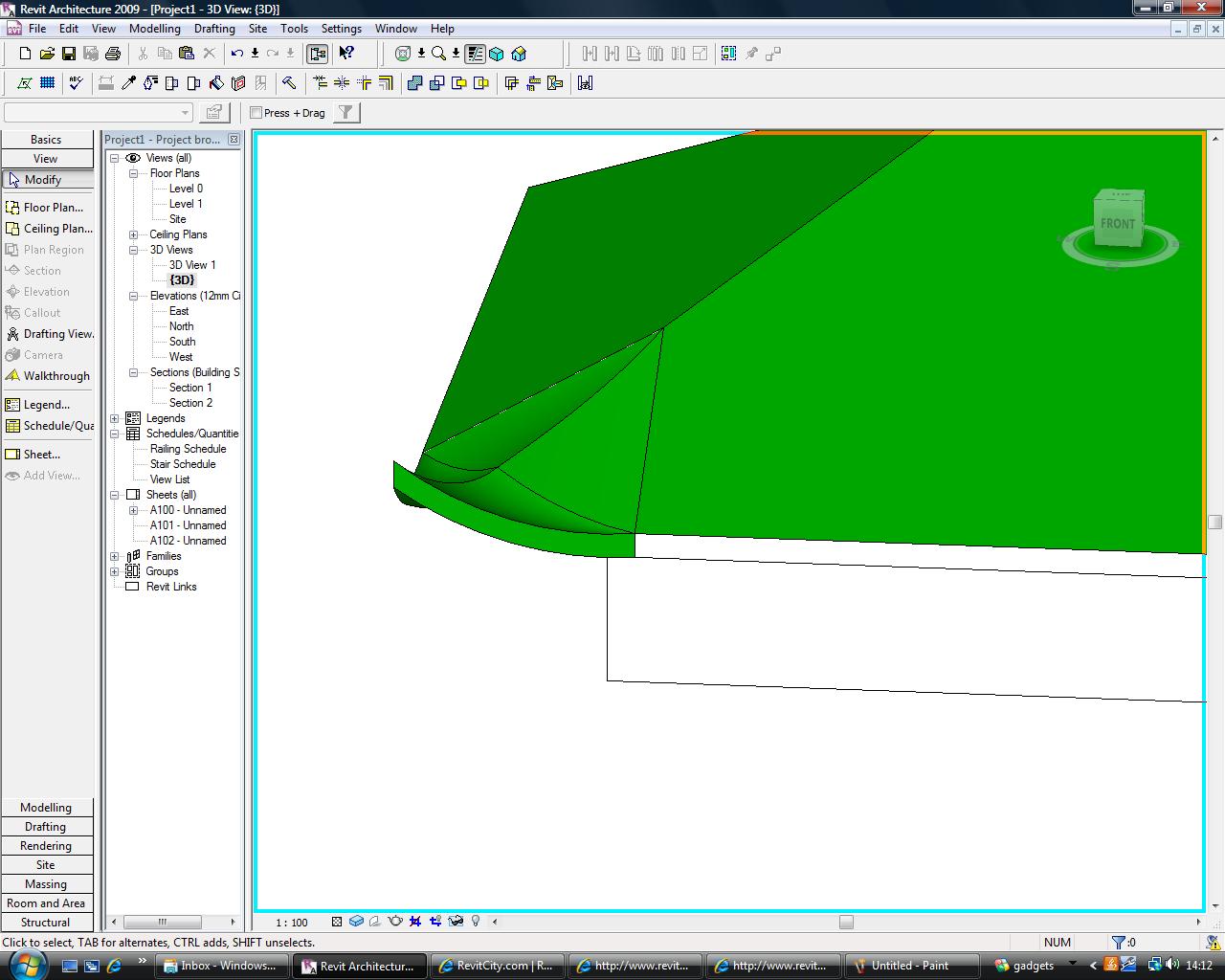

Well, i create that in "Roof by Footprint" but you can also create a "Mass" with the shape you want and then apply "Roof By Face"...

Trandung, after all, what roof do you want? the first Image or the secondly?, i only have that first picture, i don't have plans, sections or elevation views, the first roof you can do like i post, the second roof you must create the mass and then apply by face....

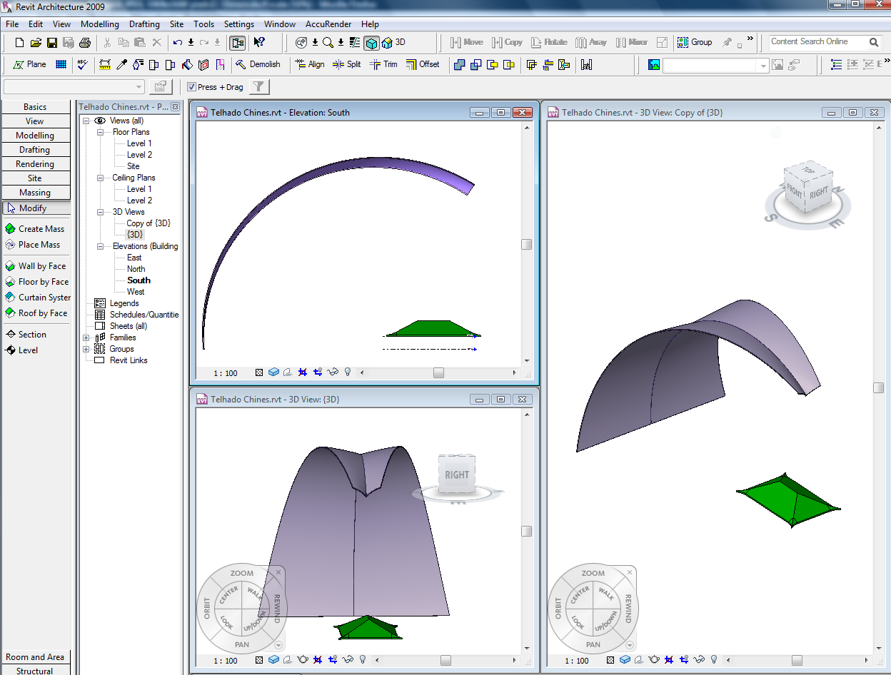

The other roof you can do that with "Mass" with "Solid Swept Blend"....

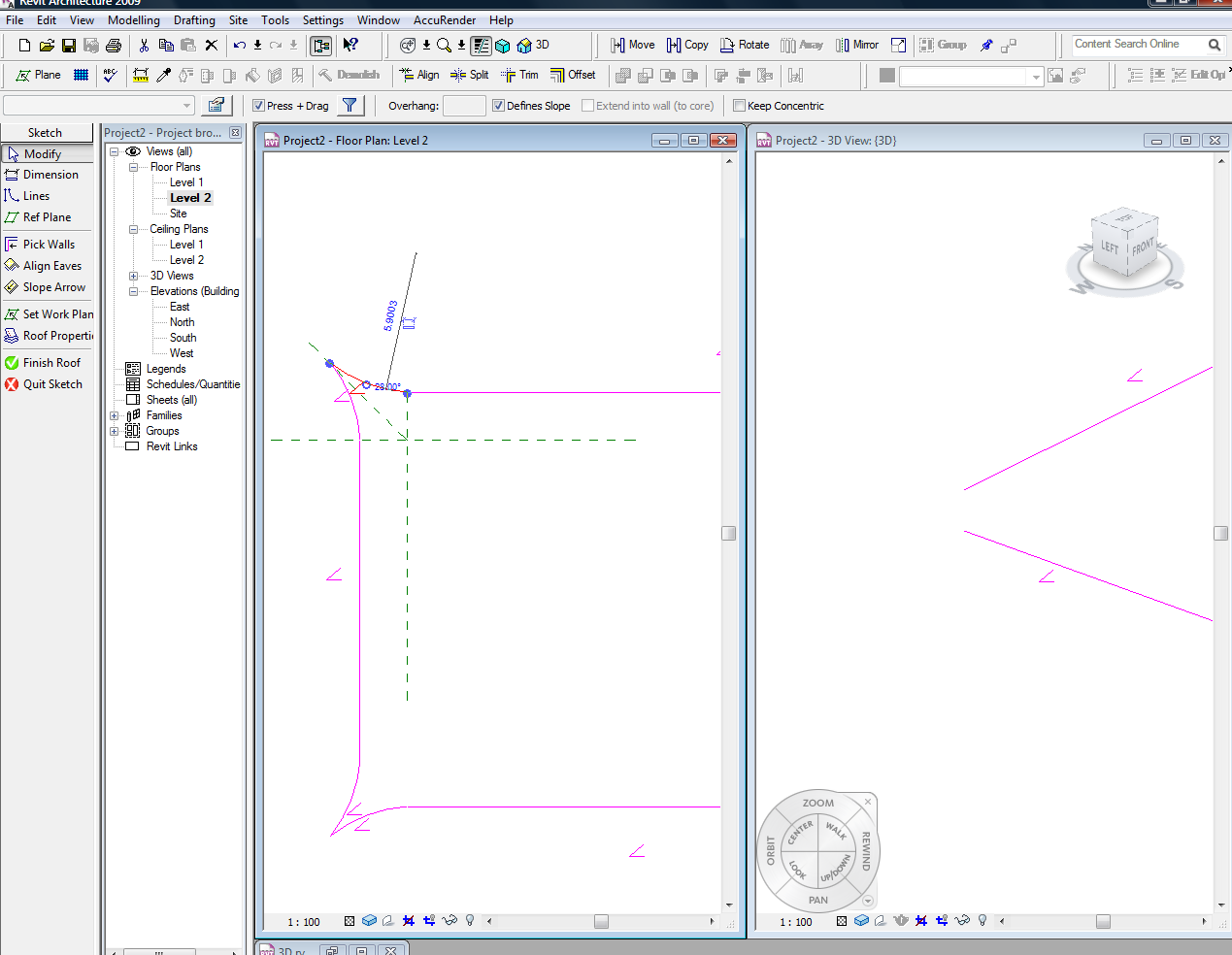

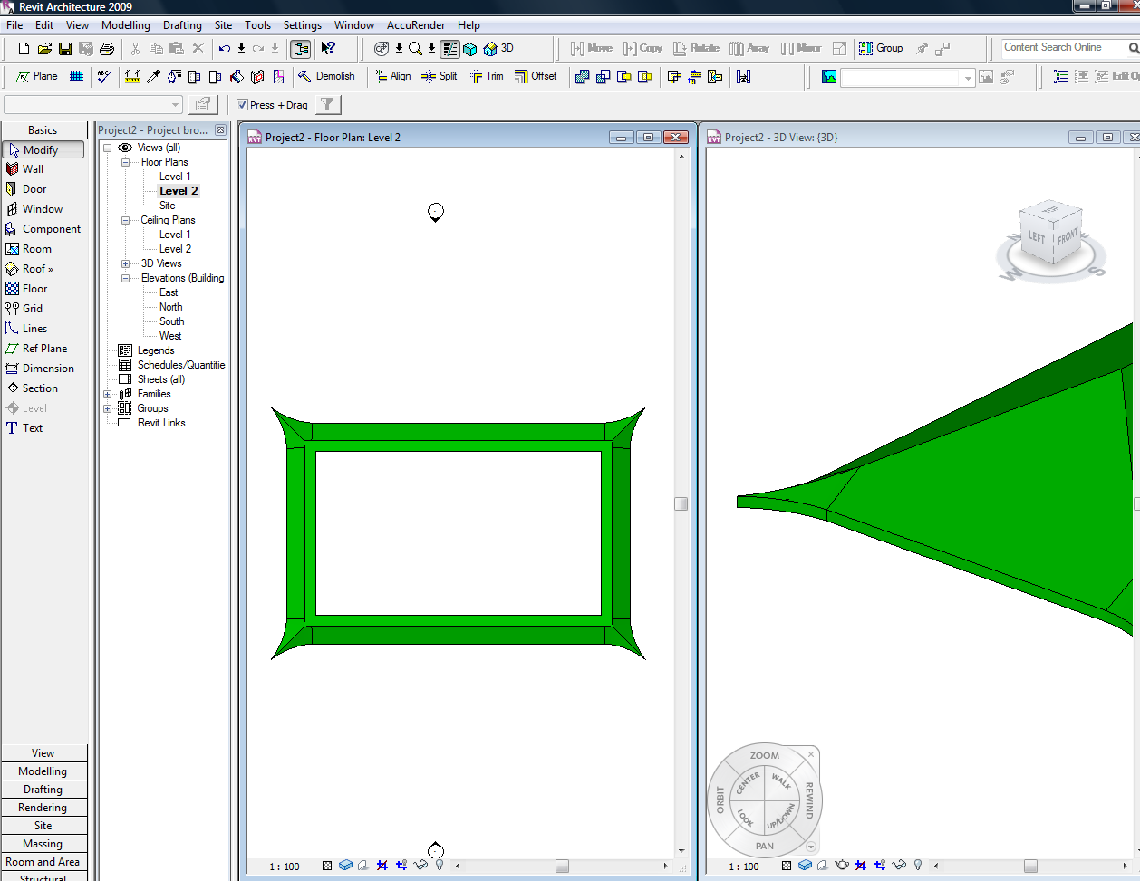

I tried this by cutting out the corner and creating a swept blend with a void.  Ty I think that the roof would look straight in a plan and curves up in the elevation.

There it is...
 Sorry, the file has 3.4Mb, i can't upload, your email???

I send by email.... good luck
