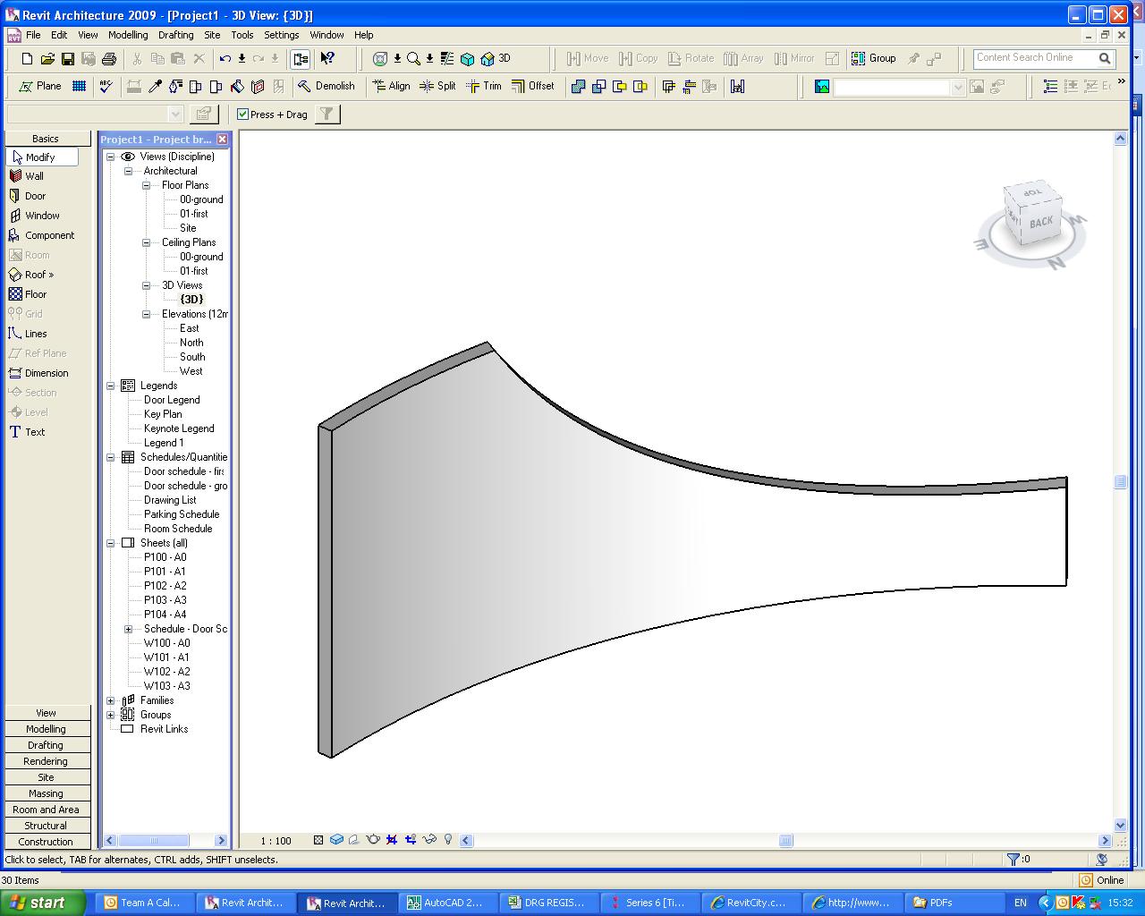

Oops I meant to attach this picture and also the stairs.  I guess you could call it a side wall.  How would you get the wall to curve up at the very end to connect to the porch?  This is in 2008.

Draw your curved wall and use a void yo cut it - see attached.

How do you do a void cut in a wall?  I don't see that option.  I am still new at this.
Tue, Dec 9, 2008 at 12:06:06 PM | curved exterior stairs
Joined: Tue, May 22, 2007
5921 Posts
4 Stars: 205 Votes
Go to "Moddeling-Create" use "Wall" category then "Void" - extrusion....

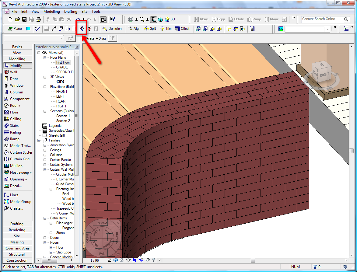

See attached it works.  Thank you so much for the video very much appreciated.  Only one more thing is there a way to show the brick on top where the void extrusion is?

Use the "Paint Tool"... see the image attached
