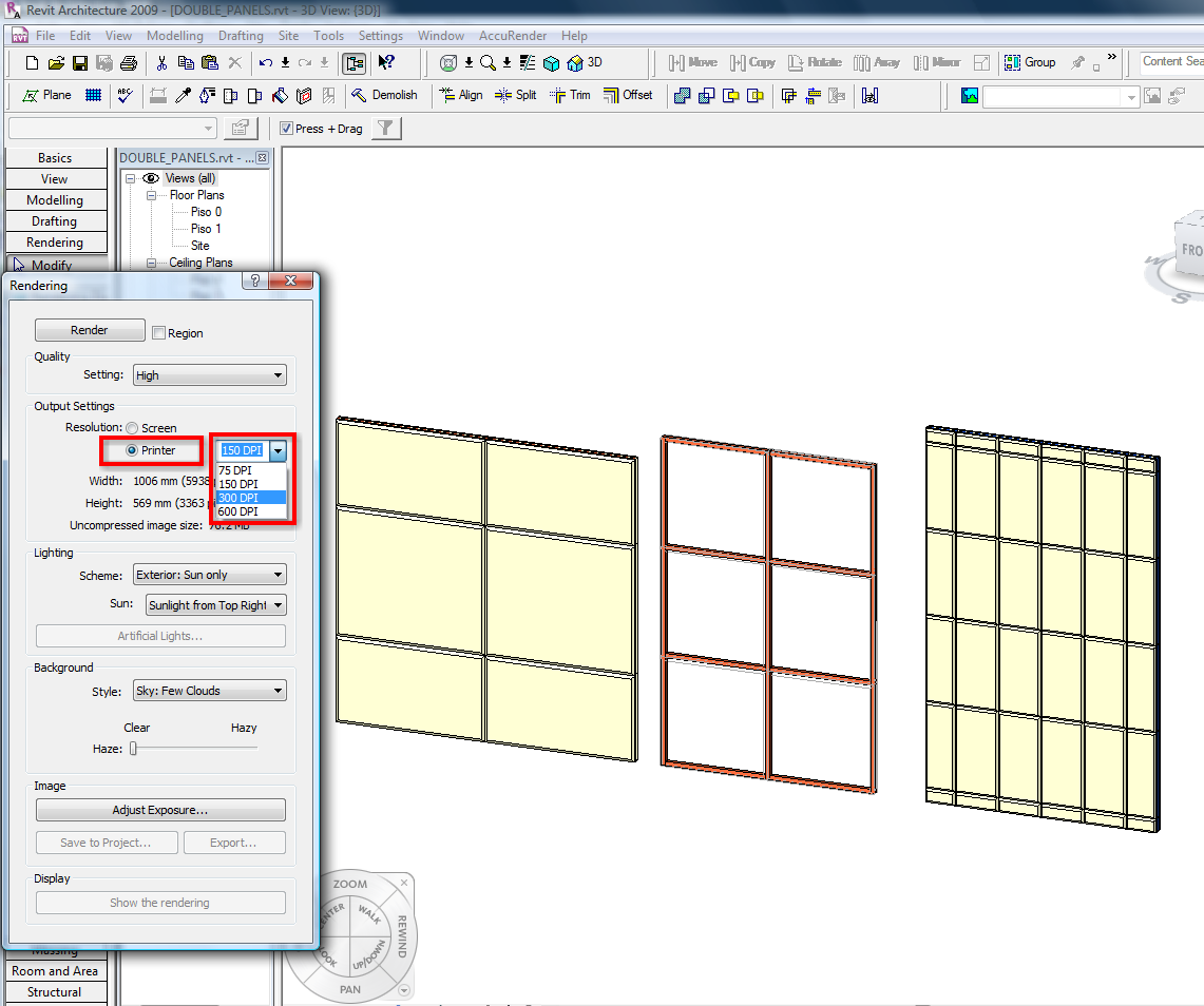

hi,
i am new to revit.
can anyone tell me how to get 300 dpi jpeg from the revit view?
 thanks

Hi, render the view you want and change the "resolution" to "Printer" and select "300 DPI"

If you don't want to render the view, go to export image and click on 'zoom to' rather than image size and then you can set the the raster image quality to 300dpi.
