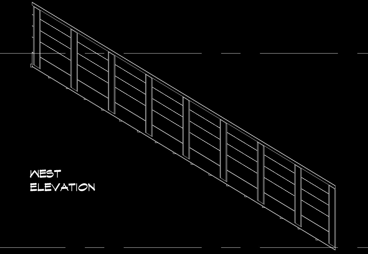

Hi for the life of me I cannot create these baulsters can anyone help..
I have loaded a image of what Iam trying to create .

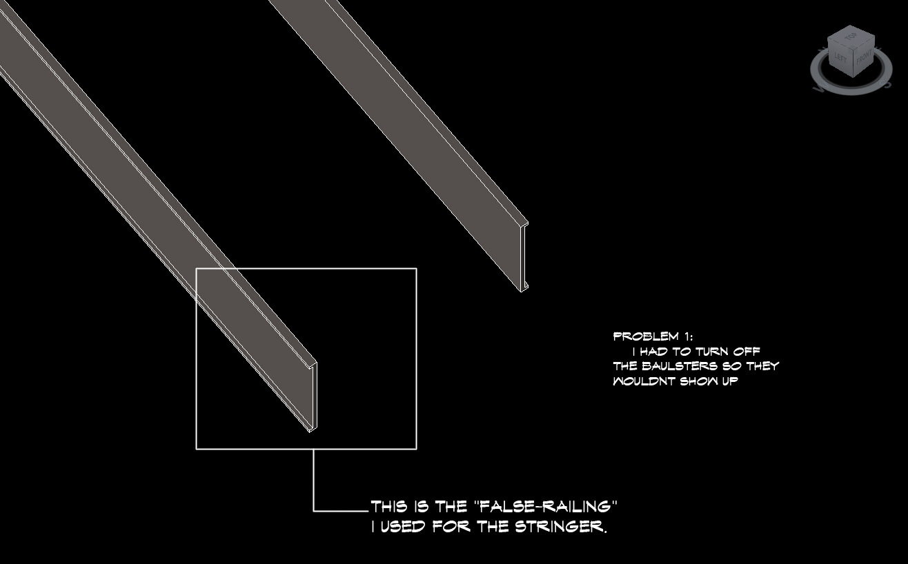

1:I have to use railings for the stringers because they were I beams
2:The baulsters have cable wires between, how do you create that
3:ANd how do I get these to work on the existing stairs that have the baulsters hidden so they dont show up on the stringers..
I cannot get this to work.
 Also I included the stairs that have the I beam stringers on them.
Thanks!!

No image attached, I would have created the stringer using the same method as you.  You can use the rails to create the cables, use a circular profile with the appropriate diameter.    Can you clarify your third question - if there are no balusters then switch them off.

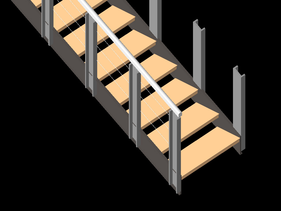

Well for some weird reason my rvt file isnt being uploaded???
but here is what Im trying to create..
So how would I position the cables in the method to create them and how would I connect the baulsters to the custom stringers that I created.

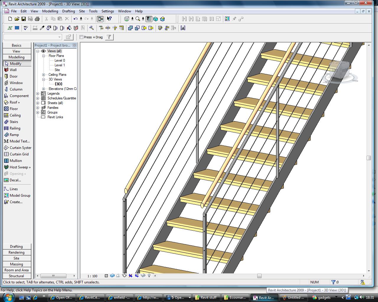

I created a standard stair and set the stringers and risers to off.  In the rail elements I went into Balusters and set the distance between them to about two meters and applied a round profile (you can create your own baluster family to have the shape that you want, with the holes and the angled base).  Under rails, I applied a round handrail and applied additional rails for the cables and stringer.

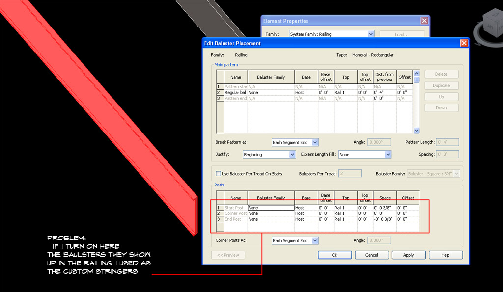

Okay thats wonderful and its about 97% what I need..
Except this:
The stringers are false railings i used them to create a "Custom C-Channel " beam for the railings
When I use the rails for the custom stringers i have to turn off the baulsters show they dont pop up on the stringers below the stairs.
So would I create a different profile for the baulsters and load it to the existing custom stairs?
And why isnt my attached rvt file coming thru with replies??

You balusters are set so that they use the profile as the top under the balusters dialogue box.  Set them to attach to the relevant rail, such as the hand rail, or give them a top height offset above the profile.

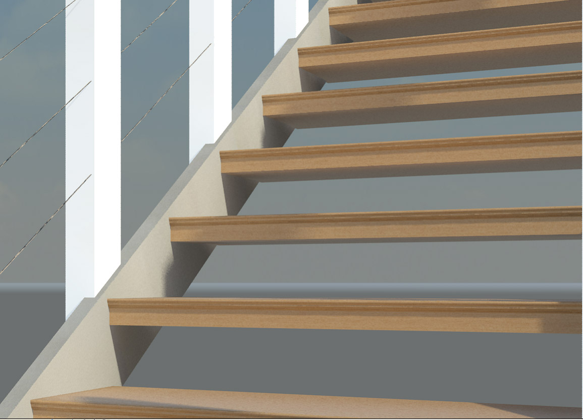

I greatly appreciate all the help..
Here is a rough draft of what I came up with
I added custom nosing also to the stairs so they dont look so plain.
 Again thanks!!!

Cool - getting there.  You can also create balusters that will align with the stringers and with a flat connection on top to join to the handrail.

I want the baulsters to overlap the stringers but to create a flat top ...I do what?
The image below is going to be the final product, I will add bolts to the baulsters and change them some.

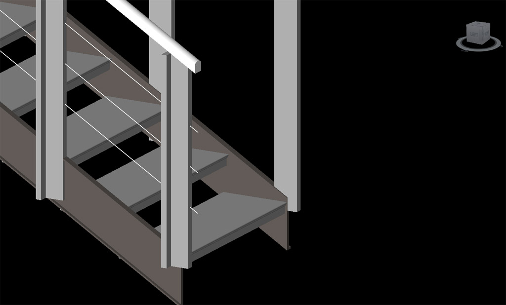

Okay another set of issues..geeze teh baulsters over shoot the end of the stringers and they now dont fully flush with the bottom of the handrail

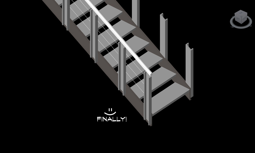

FINALLY!
Here they are..I will do the other side soon
Thanks everyone for there help.
