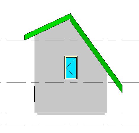

 I can't figure out how to change the centerline of my roof. I draw the roof by footprint with lines, and set two different angles on each of the slope defining sides of the roof. But how can I change or define where I want the centerline or 'back' of the roof ?

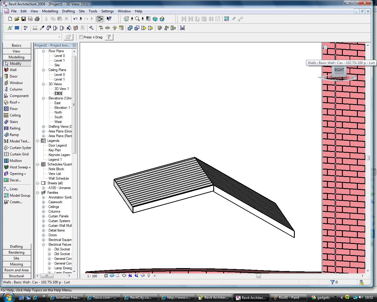

You can extrude the roof (image 1) or create two different roofs with plumb cut to get the edges vertical and then align them (image 2).

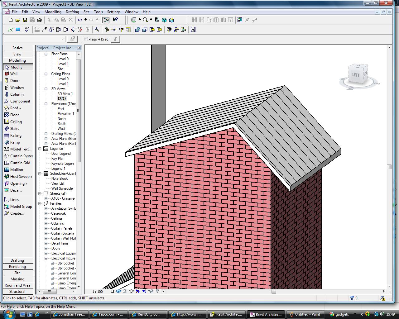

Just do your roof by footprint, then select the slope defining line that needs to go higher and change its plate height offset.  This effectively allows you to control where the ridge will be.

This is something like what i wanna do, but isn't there a way to get the roof to join probably ?
