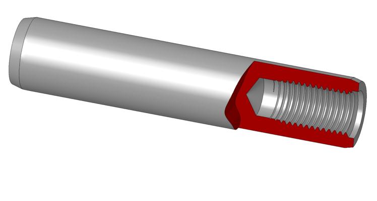

hi dylan88 & tim123....
thanks a lot for the tip.
section box works for the portion i want to show half cut.
but both views in the same sheet seem to be difficult...as we can not hide the edges of the cut  face in the duplicated view.
attached is the image of what i have in mind to do with the my building project.
please see if you can help..
