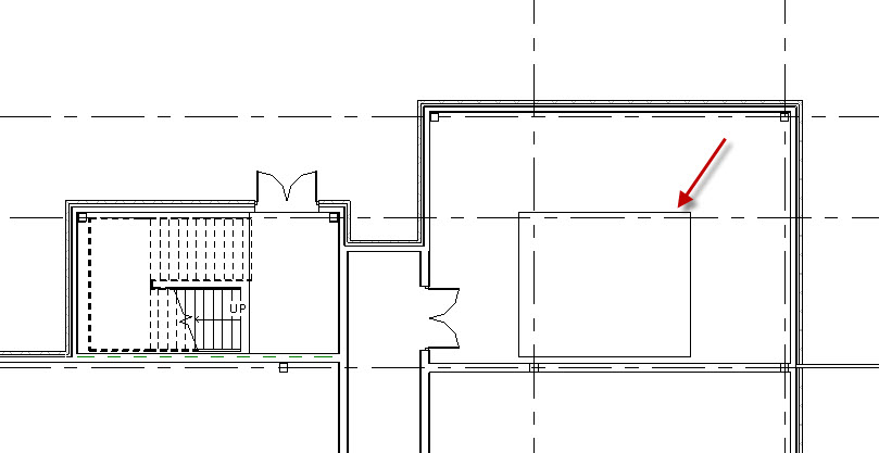

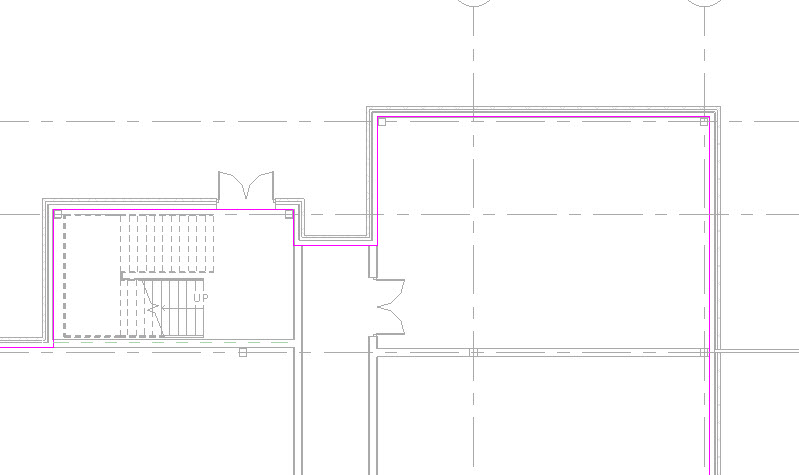

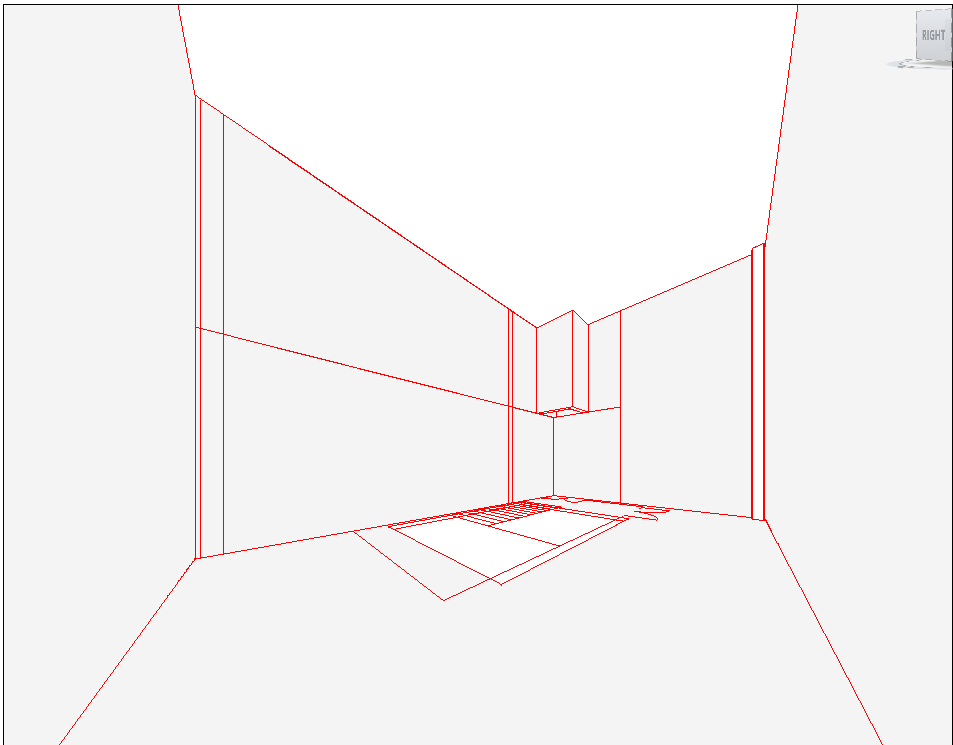

I'm having an issue with floors.  My floor has an mysterious opening it as seen in the first image, but when I go to edit this floor to eliminate it, the geometry disappears as seen in the second image.  The third image is 3d to verify that the opening is actually there.  If I delete the entire floor and redra it the opening still appears.  If I move the floor somewhere else the opening vanishes, but if I move the floor back the opening reapperas in the same spot.  I concluded that there is some thing there creating this opening.  There is no mass element; nothing hidden; nothing turned off. etc.  This used to be the location of a shaft opening, but this opening has since been deleted and this mysterious hole left in its place that can't be deleted.  Please help.

There is still a shaft opening there - there may have been two. Delete it again.

Shaft openings are not readily visible.  Try and hover your mouse over a 3d view of the opening or use your tab button on the plan.

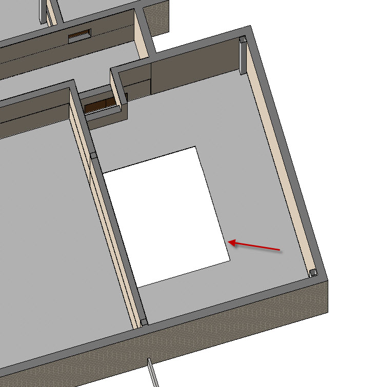

I have tried that.  There is no shaft opening there that I can highlight. The attached image shows a what was highlighted with a crossing window.  When I copy the entire plan to the side the opening vanishes.  If this was a shaft opening it would also be copied.  I do think something is there or at least the program thinks there is.

Gentlemen,  you are absolutely correct.  I am an idiot.  The shaft opening was there.  Somehow it got attached to the default foundation level (I don't know how, maybe user error).  I could only highlight the opening from this level thus it could only delete from this level and sonce I am not at the point of working on this level I never thought of checking it.  By dumb luck I checked it.  It was ignored on any other level except its base.  I apologize, you guys are brilliant.  Thanks for all the help.
