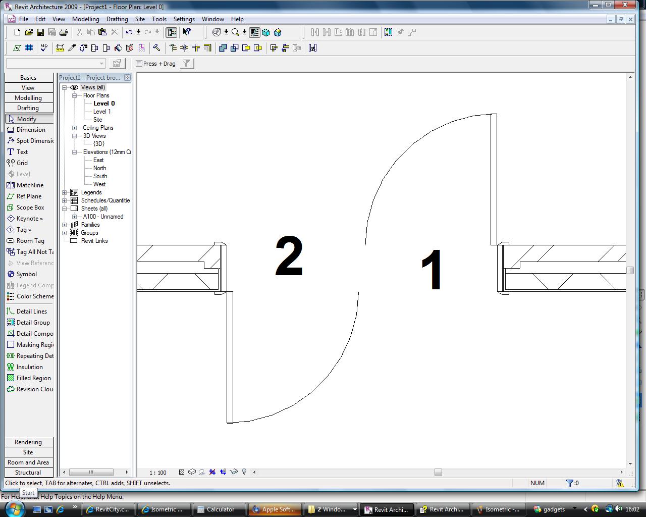

I've been trying to create a door family with a 3'-0"w frame and 2 doors in the frame. One door swinging out, and one swinging in, like a screen door and regular door on a residential home.  I've been able to create a family showing the two doors in the same frame, one swinging out and one swinging in, but i can't tag and schedule both doors individually as I'd like to.  How should I accomplish this?   thanks in advance

One way to do this is to create it as 2 different doors = see attached image.

You need a nested door family with its parameters set to shared.  One door is nothing but the leaf and load that into the other family.  Now, bot doors are tagable.

WWHUB - It worked, thanks a lot
