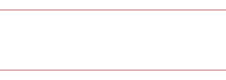

Is there any way of changing what layers of a wall (or floor or roof for that matter) display on the different detail levels? Our consultants want more simplified walls than what we're sending them in our CAD exports, but they still need to be able to have the wall core defined. The first picture is what we get with the detail level set to medium and fine, the second picture is set to course, and the third picture is the desired result at medium.

Look at your export-layers file. Structure 1&2 / Finish 1&2 / air-layer / membrane as well as common edges are all definable layers.... you can set up what will work best for you by experimentation. You just need to understand what hapens when you move items from core to finish or the oter way around. Your HELP will explain the rules on cleanup using these values.

If there aren't too many walls you can create a duplicate view for the client and use the pen tool to make the lines that you don't want invisible.
