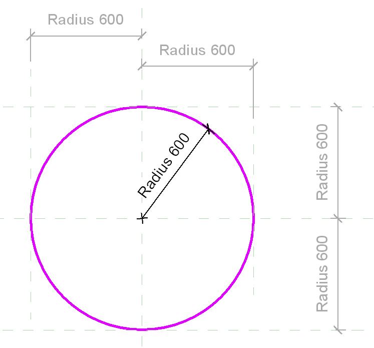

Help!!  I need to create a round table top with parameters (reduce or enlarge radius).  How do I align and lock the circle to a reference plane so that I can flex the extrusion?  I have tried locking the center point to a ref plane but that does not work.  I have downloaded tables with this feature to see how they are made with no luck.  They all seem to have locks to the ref plane....how did they get them?????

Hey, what I would do is dimension the radius of the circle, give that a parameter, and then create reference planes and dimension those. Then give those dimensions the same parameter as your radius. Im pretty sure you can't lock circles to reference planes, you can only lock it where the semicircles are. Refer to my picture for info. Would other people do my way too?

I dont't think that you need to.  If you pin the two central ref planes and create the radius extrusion and give it a radius dimension, while still creating the extrusion as in timbo90s illustration, the dimension locks to the intersection of the ref planes.

thanks guys!  turns out I was missing the first step of setting  the radial dimension before extruding.
