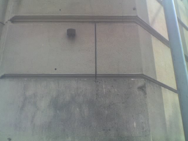

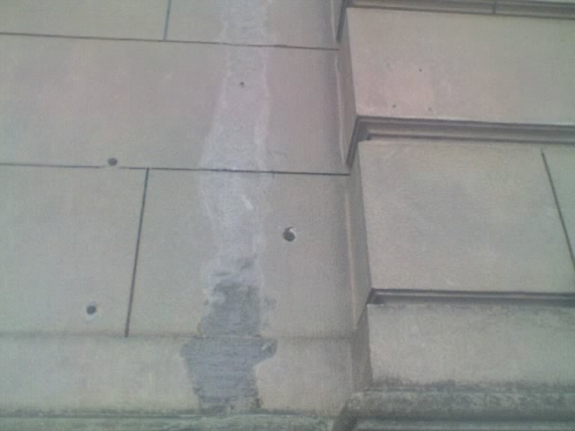

I uploaded 3 photos so you can see because I don't have any idea how you would call it in English. I want to do something like the Stucco you see in the pictures-
I was thinking about using Masses but then I would need to add doors an windows which will be behind the mass.
Then I realized I can use a tool called Host Sweep: Wall Reveal but it does not allowed to add doors or windows (you get an error)
Thanks a lot!

You shoul dbe able to put walls and windows through a host sweep, but I prefer to do this under the edit wall where you have much more control.  Go to wall properties, go to edit, and edit structure.  If you press preview (bottom left) and click section, the sweeps button becomes available.  Add the sweep profiles that you require and set the height and offset.

You need to use :
1. Modeling/Host Sweep/Wall Sweep for short horizon and  vertical
2. Type properties/edit (structure)/Sweep for horizon (whole length of wall)
