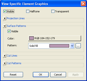

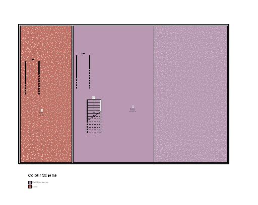

I can overide the graphics in view and turn the stair transparent - this seems to work for me.  See attached image.

I've tried to recreate that without success until I realised that I had opened Revit 2008 this morning to try it out.  Works in 2008 but not 2009.  I'm trying to figure out why - I'll get back when I find out.

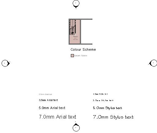

I cannot see an option to make this work.  I thought that the solid fill may be set as opaque but this is not the problem.  An alternative is to overide the stair graphics - see attached images.
