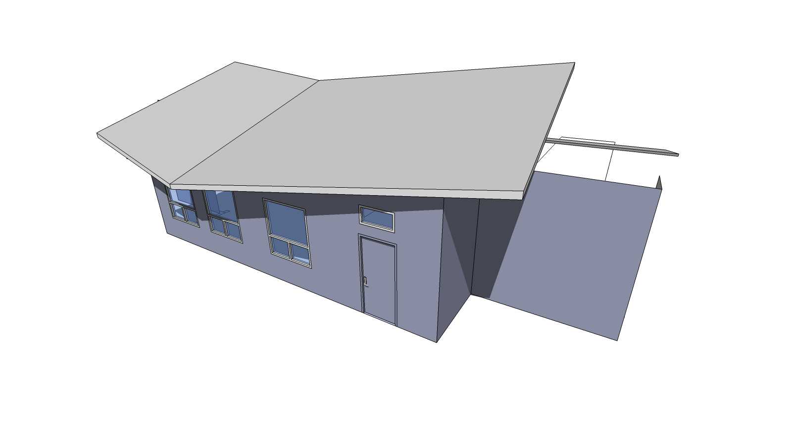

Another fresh-faced Revit recruit joining the ranks...I'm using Revit 2009 attempting to model this roof condition.  I need a little direction figuring out the rotation part.  I've got the roof drawn as two simple sheds sloping inward towards one another, select the roofs in elevation and try to rotate them but get an error "can't change plane of roof sketch."
I'm sure there are several ways one would approach this, any advice would be greatly appreciated.
Thanks in advance.
(quick image attached done in SU)

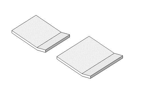

I haven't use Revit long enough too, but I think, to create roof like that... we can do it either using negatif slope angle by footprint.. or just using Roof by extrusion...
Attached is roof creating with roof by footprint (Left) & roof by extrusion (Right)

Vicozzio has right, i don't see where is the problem to create and/or modify a roof like that, you can create by "footprint or Extrusion".
"Should I be defining a work plane or maybe using massing tools instead?" - For What???

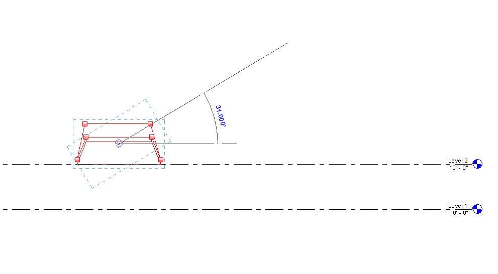

Thanks for the comments thus far.  I guess what my original image doesn't show very well is this butterfly roof is rotated along the longitudial axis.  Attached is a screen cap showing what I'm trying to do -- this is looking at the end condition (transverse) to the roof.  Whether I select the roof assembly or edit the roof and select the sketch, I can't get this to rotate.

If you post that screen shot for the begining i would told you: Massing - Extrusion sweep - roof by face
