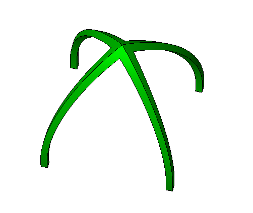

You can use void forms - see attached image.
Is this what you mean?

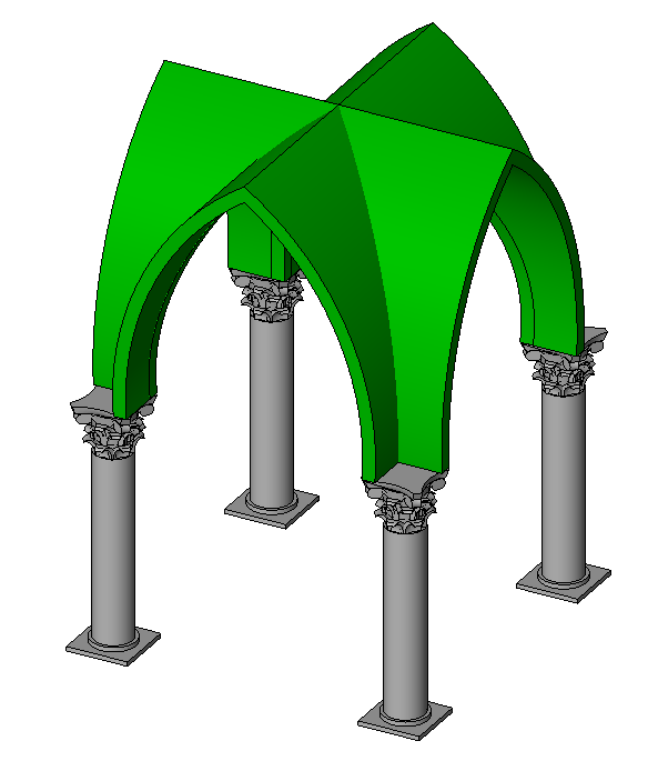

Hi, do you have some images of what do you need, it's something like this?
Vault from above.

You can do a lot of things with the voids...

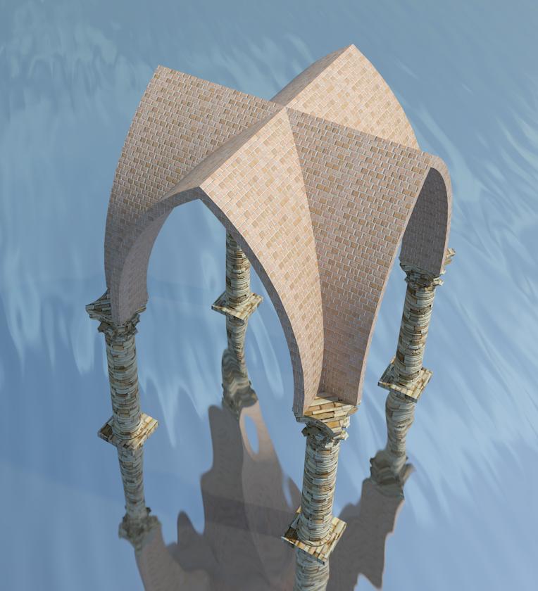

Look at the gallery: this is what you Architect want?
