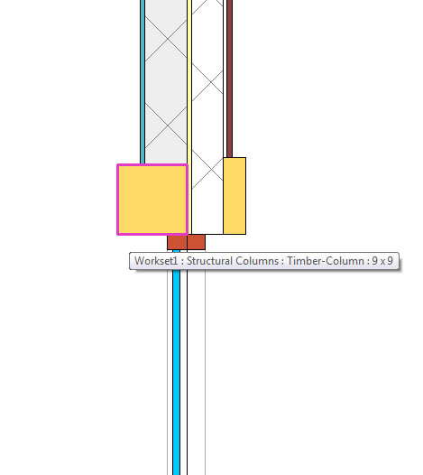

i have come accross a situation where i have posts between my walls, when i finish the wall against the rectangular timber post, the wall hatch pattern runs over the post cut pattern, even when the post has a solid cut pattern. I eventually just overide "columns" catagory to be a solid colour and this worked, but is there another way of not letting the wall hatch run through the column.

Did you use structural columns or columns from the modelling tab? Refer to pic and tell us which one you chose.

There is two kinds of columns in revit, Architectural columns and Structural columns, the first is "envolved" by the walls (pattern of the wall), the second it assumes the pattern of the column, see the images...

hey thanks for the tips guys, that was the problem, he had used structural columns and not architectural columns.

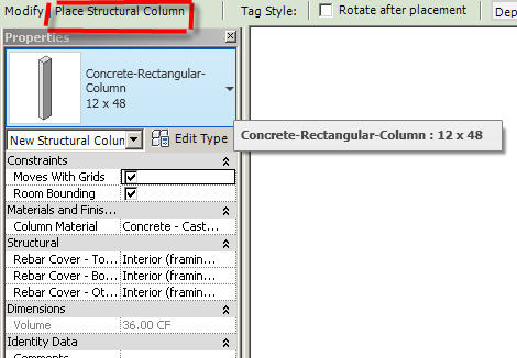

YES, I AM USING A STRUCTURAL COLUMN! See my attached picture. If, I'm not using a STRUCTURAL COLUMN then show me where I sould be getting one from. I'm using Revit Structure 2011 not Revit Architecture.

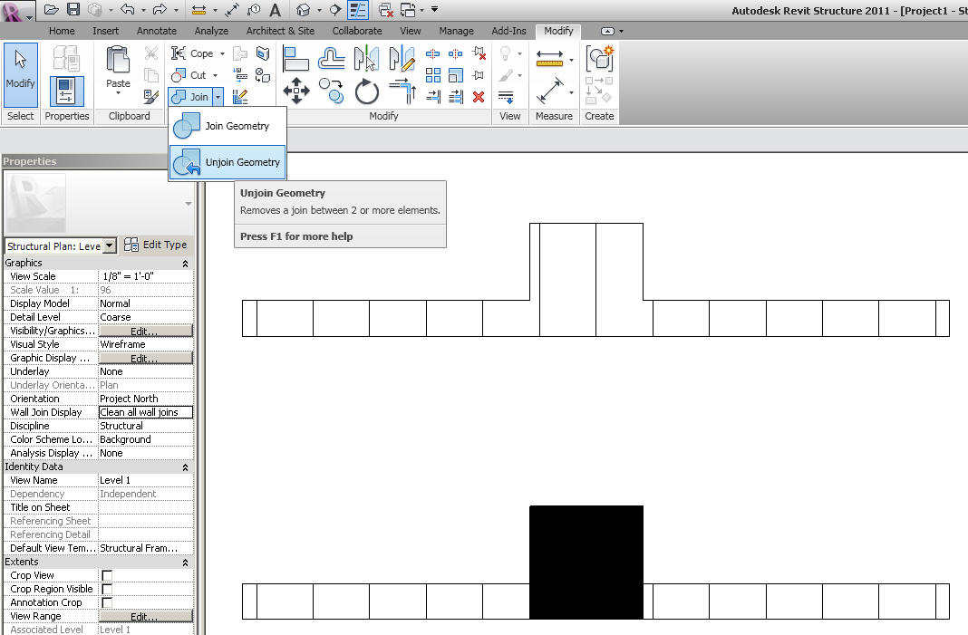

i have a problem . i have some structural columns in different walls and in plans i want to see the patterns cut (a solid color) . i can't find a solutions. please help ! i have attach a image to see more clear my problem. sorry for my bad english. hope someone can help me !

nistorkool,
Okay, this is what I've figured out with the structural columns and the walls. There are a few options you can do. If you are placing the column inside the wall and it is absorbing the material of the wall you have to unjoin the column from the wall. The wall will still be running through the column but you can get a different pattern on the column by doing this. Do this by either selecting the column or just go to the modify tab and click the down arrow next to the join command and select unjoin. It should then show you what you want.
If you are wanting to actually cut the wall out of the column you will have to edit profile in elevation which in some cases still will not display correctly. Or you want seperate walls, one on either side of the column and then you still might have to unjoin if the walls absorb the column.
Another way that I've seen done, which if you aren't looking to use the model for anything other than a pretty picture and you're not sending it to the architect you could create a wall type (name it with a column tag name (CC-1)) then set the pattern you want and then you can draw the wall and tag it will a wall tag that would have the column callout in it. See if this works and let me know if this is what you are looking for.
