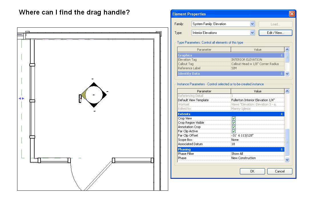

What causes me to loose those blue handles (drag/clip adjustment) on some of my enlarged plans? Thanks.

Here's what I mean. In some cases, I can't find those drag handles on plan. If I start a new project, it shows. In the project that I'm now doing, sometimes I see, sometimes I dont.

well to get the blue dots on the end you have to turn on the crop view in that elevation.

for the other half I'm not sure why you can't see them other then they aren't where you think they are.

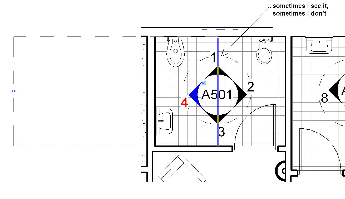

Here's another screenshot of a roomin the same project I'm working on. THanks

Oops. Sorry, no image. Try again.

If you are talking specifically about view-handles...
the 'far clip offset' option in the element properties box controls the depth of your view- I've sometimes seen this default to stagering depths...mostly in callouts...but don't know why.

you have an associated datum.  I don't know what this is used for (i should probably know, i should f1 it and find out) but once you set it from none to anything then that line goes away.  then things may work funny afterwards.

I don't know about that Associated Datum where it came from. I change it to None and found my blue handle along grid 18. I tried to drag it back into the callout box but I can't. So I deleted that view and make a new one and so, found my handles back again. Thanks.
