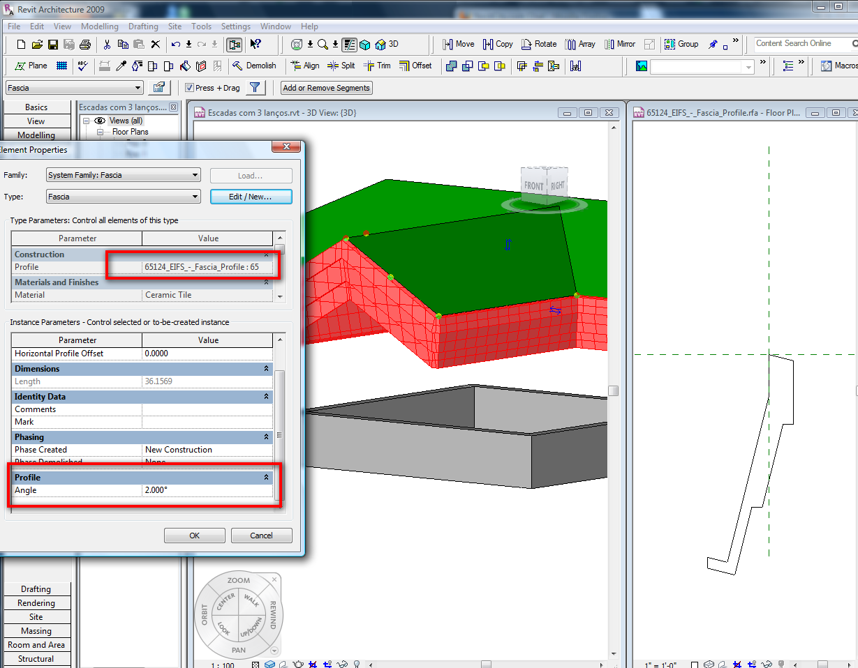

Is this Fascia a little BIG?? Only in the Gable you have the problem right?? what i do was change a little bit the angle of the fascia, don't solve the REAL problem but...
To do that i think i use a "In-place" - "Solid sweep" with that profile.....

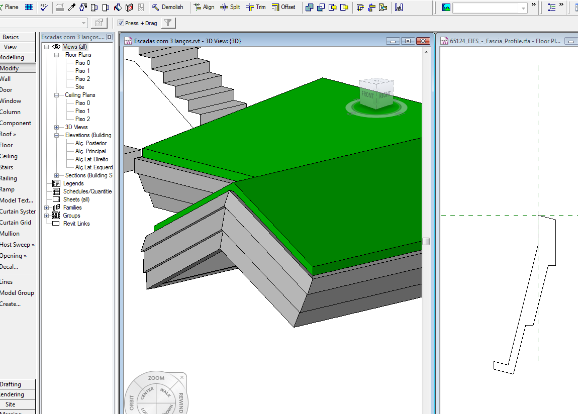

This is with Solid Sweep with that profile....

i will try changing the angle like you did but i am afriad that i will just have to hide it all in the wall sections and details...yes it is big but the designer doesnt care he only wants it right...so guess who has to have the head ache of fixing it...

So, use the In-place with Solid sweep....

dude - i am giving you a five star rating!  that in place family worked...you are now my favorite revit user!

still a little weird at the corners but it is much better then what i was doing...having the ends crash through each other was not acceptable

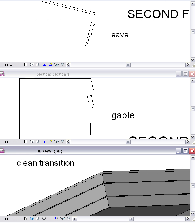

last thing, if we can solve this problem i will not have any more issues with this stupid fascia.  if i start the sweep on the eave the rake is wrong under the gable, if i start on the gable the eave is wrong...any suggestions.  something about the transition from one side to the next rotates the fasica...i would like it to have the top part vertical like the eave is showing but have the rake vertical too.
