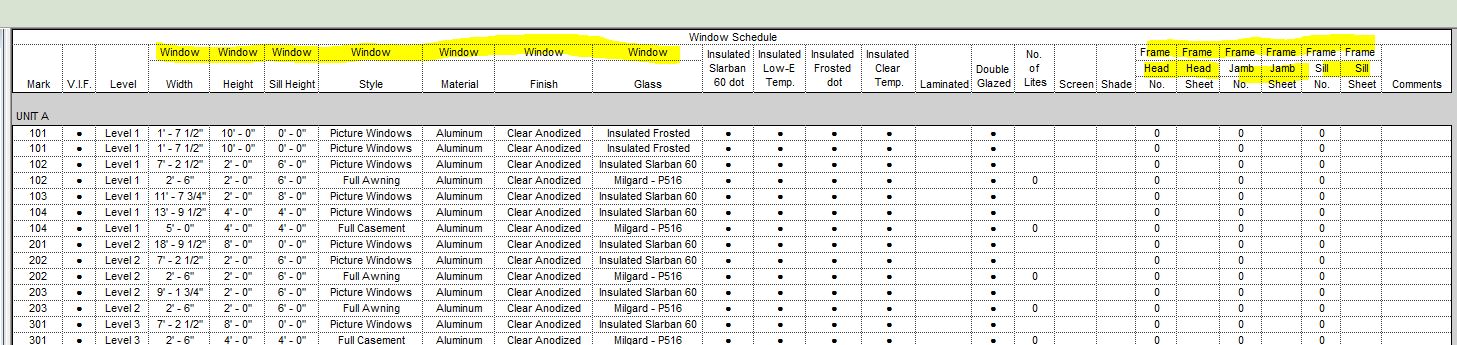

Hi Guys! I realize this thread is ancient but I'm having issues with grouped cell headers and I cannot figure it out for the life of me. I joined several headers in my schedule and now they have split again. I can no longer join them, and I can't delete them.
Please let me know if this is a bug or if there's any solution.

Please see attached pdf file. I'm working on Revit 2013.
Try followings:
1. Go to Schedule View.
2. Select the cells you want to have the group header, my case was select "HEAD", "JAMB" and "SILL", then right click, in pop-up window select "Group Headers".
3. A new empty grouped cell will be shown on top of those three cells.
4. You can type any word in there, I typed "DETAILS".
5. Then turn to sheet view, my case is A-101, you can drag them to set up the height and width as you like.
