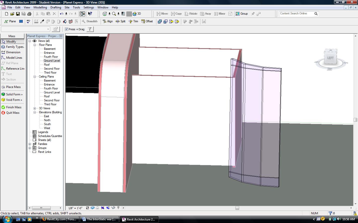

im currently working on modleing the Planet Express building from the show Futurama. I am working on the tower and i am using a swept mass for the base. what happens is that the top and base portiations of the mass are not even. how do i get them to be even?

Hi Hammer, i think you sketch the path with some inclination, in a elevation view see if the model have an inclination, if so, edit the sweep and rebuild your path in a elevation view (vertically).

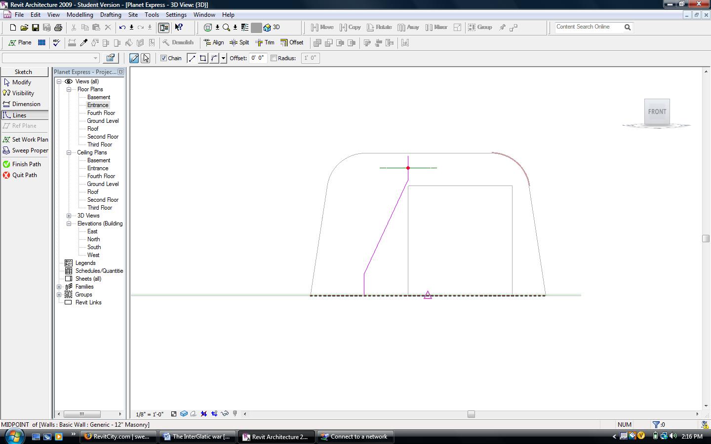

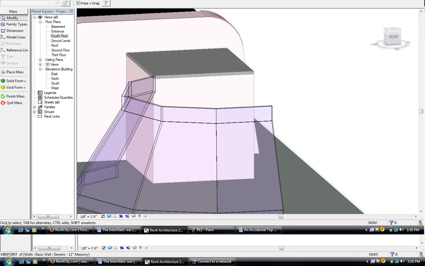

well what i just did was sketch the path from the top view, then sketched the profile from one of the elevation views. the result is below

No, i said to sketch the "PATH" in a elevation view just like you did, and the profile in REF LEVEL...

Can you put the images from that element in ELEVATION and a better image in a 3D VIEW?

ooow, i see now much better,, seems ok, you can do that, Path in Plan and Profile in elevation.

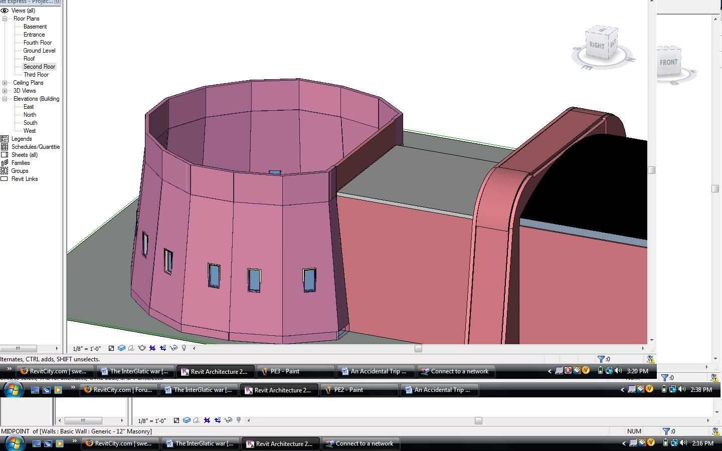

well heres the final product. after  i finished the sweep, i did a wall by face
My Futurama Fan Fiction 'Hammer087' - http://futurama-madhouse.com.ar/fanfic/indexh.shtml#hammer087
