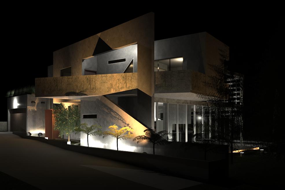

i downloaded  Revit 2009 trial from autodesk and got a first peek at the sofeware. the first thing i did was get and old job from v.2008 and picked a view to render. i must be doing someting wrong !!! what happen to reytrace, my rendering came out very bad and i mean bed. what am i diong wrong. i no it a lot to cover, but can someone tell me that their is hope.

i just use camrea view and go to the settings for sun and lights. i render it in draft or med. about 5 times to see if i got the lighting right, the if it looks good ill render it in presintation mode. talks about 30 min. looks good for me. you can check my uploads, i do ok. but im useing the down load v. 2009 trial and when i render it comes out really bad. you cant even see it. scramble eggs. also the download of revit struc. dose the same. iv tried 2 comp. no good. ill see if i can get a disc, maybe it will help or go talk to a reseller..... thanks

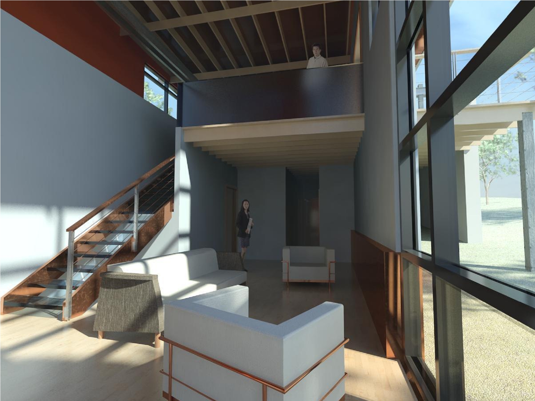

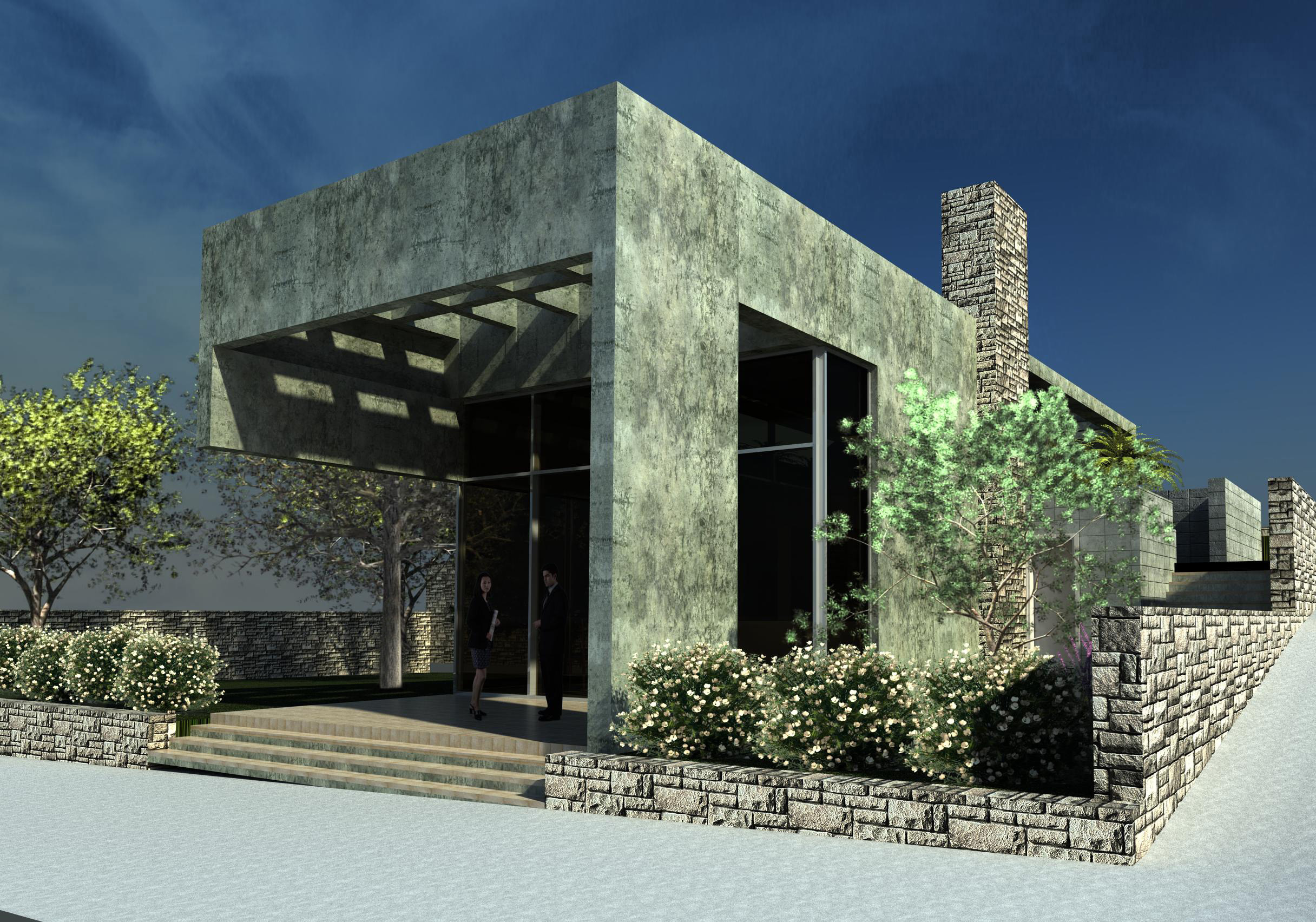

I have to say I love the new Mental Ray engine. There are some issue with 2008 projects where not all your materials come over and you have to re-apply, but overall this is a major step forward.
Here's a link to some more info on the rendering: http://www.revitup.co.za/main/page_home_2009_guide_revit_goes_mental.html
It explains about the new Pro Materials, RPC and lighting in Revit.
Here's an image I rendered from an Autodesk model they showed at Tech Camp this year... it took 4 hours on maximum quality... 1/2 that on medium.

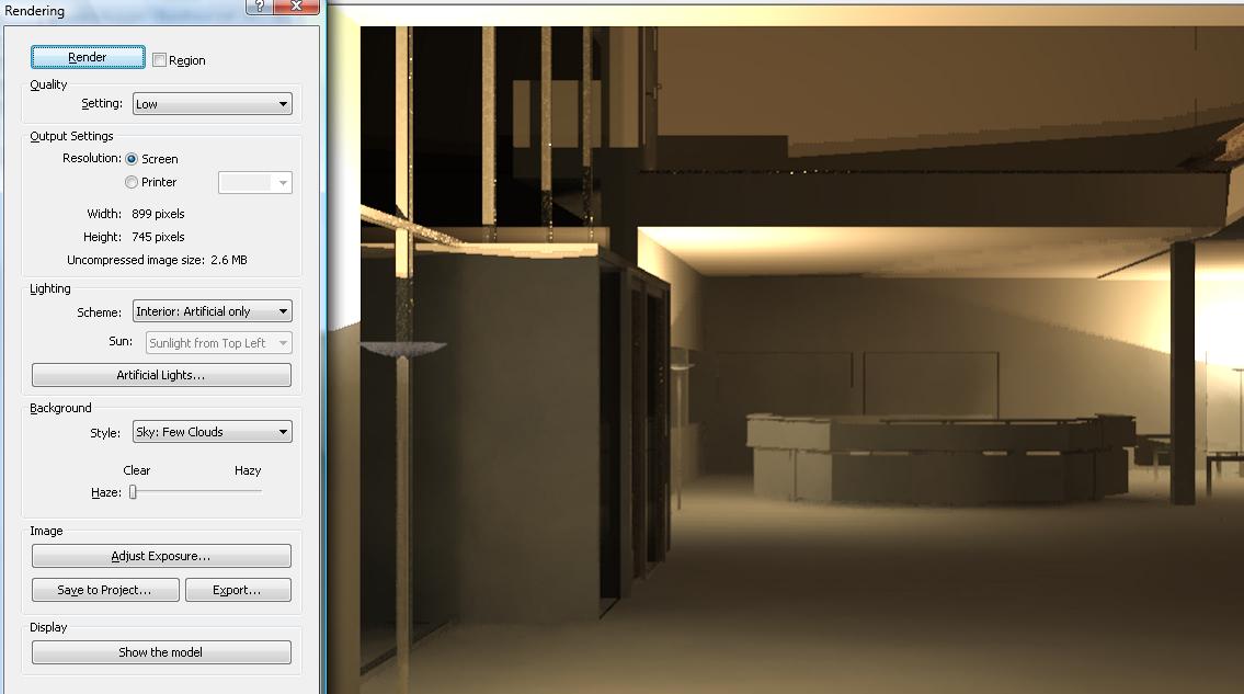

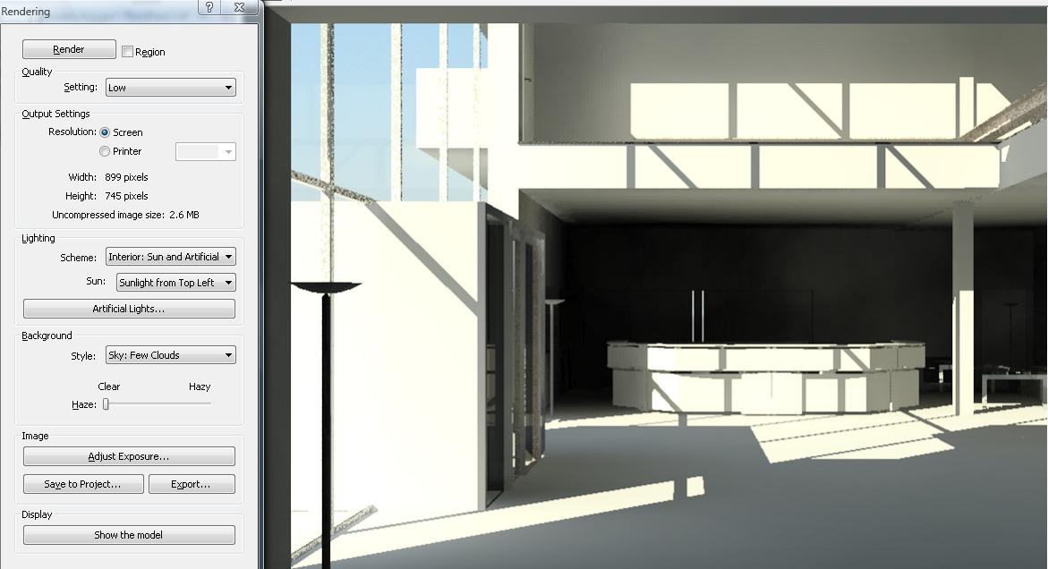

28 Posts
Anyone know why my interior lights dont work?
If i set it to "sun and artificial lights" the artificial lights dont work. If i set it to "Artificial lights only" they work. See images

yeh i ahd the same problem Sad

I think there are some issues with this new version, the lights are one of them, i don't know if there is (yet) a Service Pack to 2009, i can't find anythink in Autodesk site...
