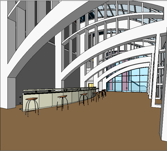

I have been struggling to add light fixtures to a mass that I import from a Revit file. I was just wondering if there is anybody out there that knows any solution to my problem.Thank you
