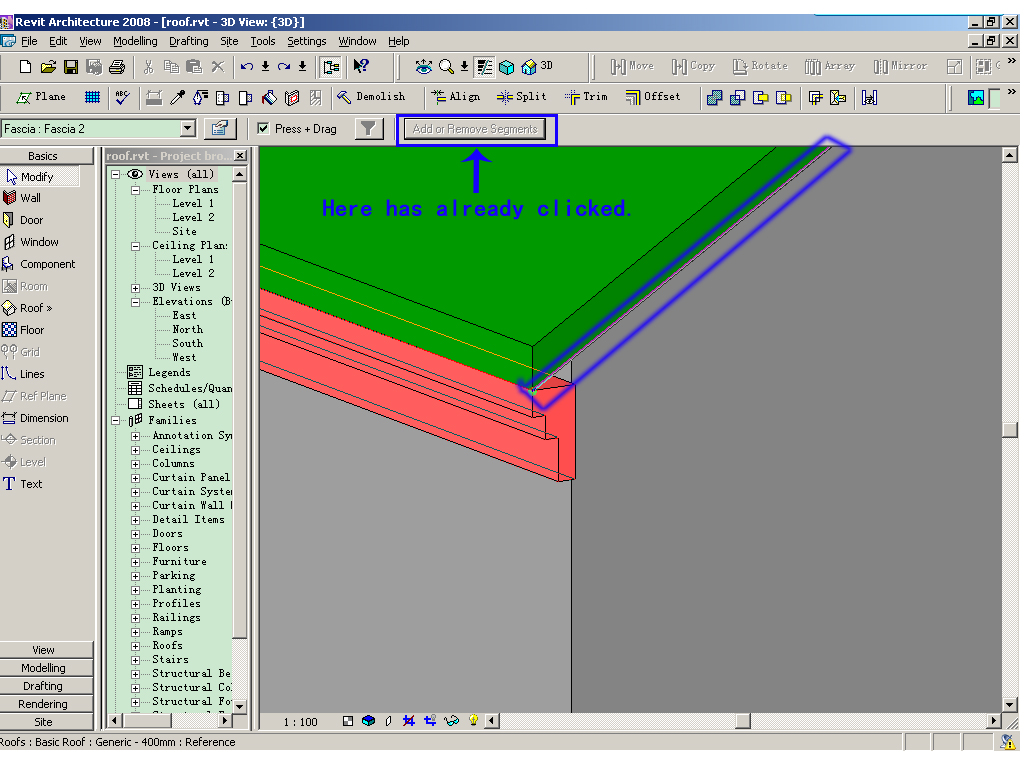

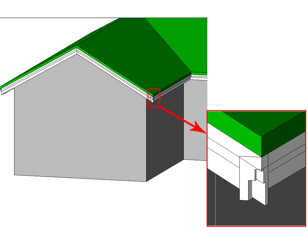

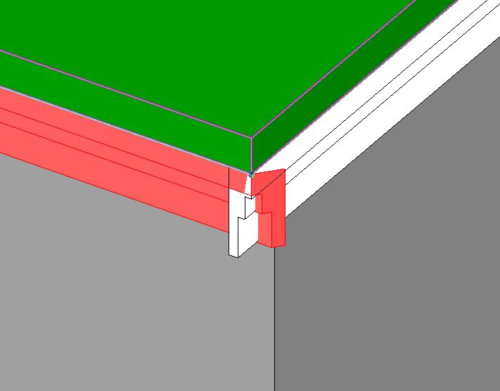

Look at the  image,how to get the two roof fascia joined well..Thank you...

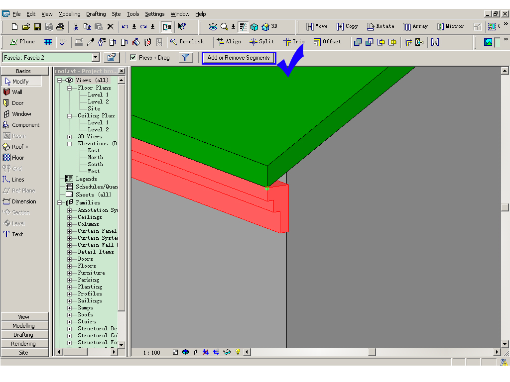

Tue, Apr 15, 2008 at 9:47:00 AM | Roof fascia!
Delete the one we see as white in your jpeg.  Then click on the other and choose add or remove walls from the options bar.  Now select the other wall and the corner should be correct.

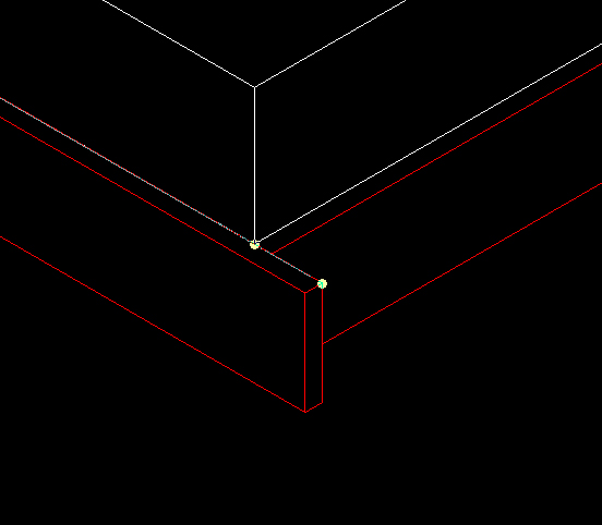

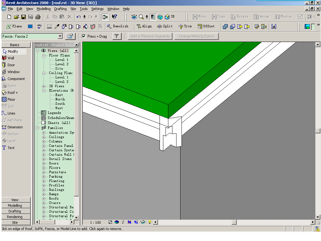

Thanks for your help.
Look at the images 01,02,and 03 ,do you mean this?
But it seems doesn't work...
Tue, Apr 15, 2008 at 11:58:32 AM | Roof fascia!
Don't know what your doing but it works fine here.... just tried it again.  Works for both fascias and cornices.

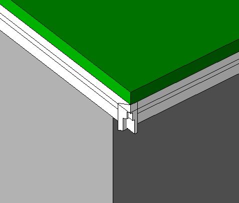

Maybe it's mistake,i didn't show the question clearly..
Please see the image i showed,the roof here is  a slope.
How can get the two roof fascia joined together?

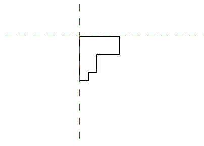

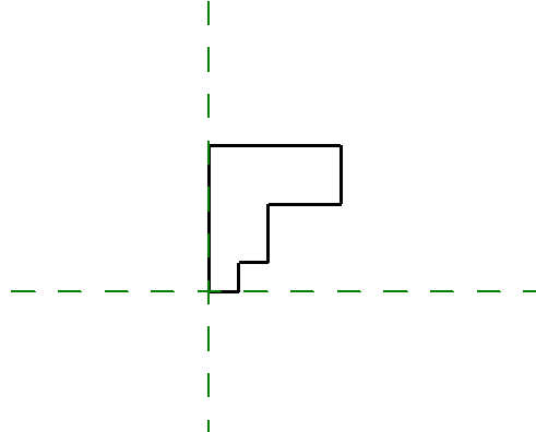

its how u made your profile see images below.
image on the left is the wrong way to make that profile image on left is the correct way to make that profile.

The way i made the profile is correct.But when i make the roof fascia,the corner here is always can't joined well.

i re made your example and it works fine, re make your profile as i have shown and it should work if you like you can post yo0ur file.

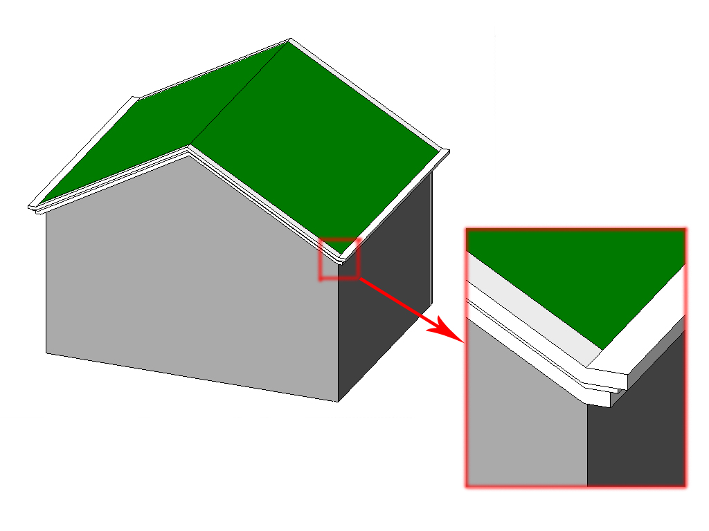

I have re-make the profile as you shown,and make the roof fascia as i attached (Roof fascia-01),the corner is joined well.But this is not what i want..
The roof fascia here is outside the roof,next to the roof,what i want is the image (Roof fascia-02),the roof fascia under
the roof.
Mon, Apr 28, 2008 at 7:22:31 AM | Roof fascia!
#14
KingRevit
Joined: Mon, Oct 15, 2007
321 Posts
4 Stars: 12 Votes
when placing the fascia offset it.
