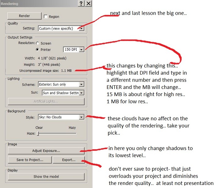

okay table i'm back..
as you can see in this thread there are some render
masters here..
hisdirt for one clearly understands what rendering is..
and yes rendering is very exciting.. but i hope it doesn't
distract you too much from learning to create construction
documents like it has with me.. lol
i read what everyone is saying here about rendering and it's
all true- but i thought i would show you how to get a good
rendering step by step and then you can learn the theories
later..
although even to walk you step by step to a good rendering
i need to explain the bare minimum of theory..
first thing i will say is that i'm only going to be talking about
EXTERIOR rendering here.. interior rendering is a horse
of a different color..
but let's get this one theory out of the way..
you know like when you go to YouTube and you can choose
the low res version of the video or the HD version?
well that is basically what you should think about with rendering..
the low res rendering version is done in about 3 minutes- and the
the high res rendering is done in about 20 minutes- (depending
on the power of your computer)..
the one you do in 3 min is just for quick looking at
what you got- like if you are building something and you want
to see how it actually went together- or you want to see that
everything is the way you want it before you make a PRESENTATION
rendering..
there is only ONE number you want to look at to determine
if it's going to be a high res or low res- it's the MB number with
PRINTER selected and not screen.. (forget about ever selecting screen)..
the only difference between a low res render and a high res
is that a high res is just rendered at a LARGER SIZE (MB)- and then
SHRUNK down so it becomes high res when you print or view it..
(you also need to know how to resize images in paint)..
so that's the FIRST thing to get planted in your head- and
this image i attached points out what i've said here.. don't
worry yet about how to make these settings- just understand
what we have so far..
oh yeah one thing i forgot to mention is that you always
render your scene within the crop region..
some of these things you will already know but i have to
go from start to finish..
let me know here when you understand everything
about this first part so i can go on to the second part..

okay now remember you want to decide if you
will render the scene low or high res.. and like
i said you watch that MB number on the main
render dialog..
once you understand this second part
you will be 2/3 an exterior render expert..
look at the image of this main dialog and
try these things out and when you got
it down good we will move on to the last
part- custom render settings..
let me know if you have any questions about
this main dialog before we get into custom settings..

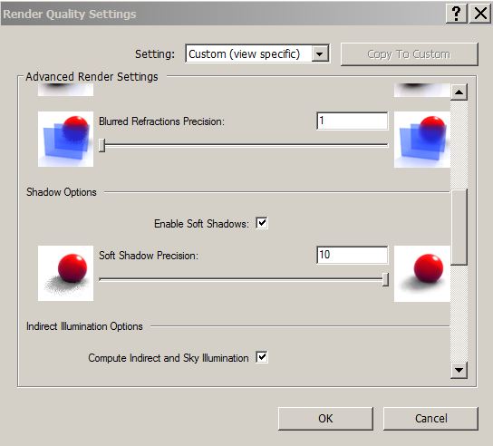

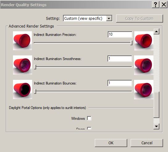

okay table- here you go-
get the crop region around your scene the way you want it..
hit the render teapot..
select printer as opposed to screen..
make it show 15MB..
hit "adjust exposure" and put shadows at the very minimum..
now go back up to the top of the render dialog and drop down
the "setting" field and select "edit"..
i attached three images to show exactly the way to
set all the sliders and check boxes..
once it starts rendering uncheck that timer dialog
so it doesn't close when the rendering is done so
you can make a note of how much time it took..
then export the image as a .bmp if you want to
save the sky or background color- or .tiff if you
want the highest quality printing- but you will
lose any background or sky.. probably best
to just select white color for the background
in the first place for now and export .tiff..
let me know how it goes..

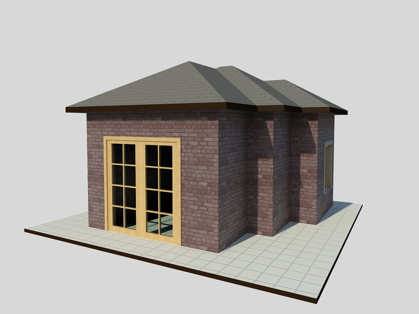

Thanks mate... see attached rendering below. All settings used as you said, 15.1MB, took 10 hours 54 to render!!!
http://img180.imageshack.us/img180/6199/3dview1.jpg
I'm still not happy with it. To be honest i don't notice a difference between the settings i'd used and what you'd said... It's gotta be my textures that are lacking?? Where's the best place to download (or possibly buy) materials and textures that actually look good?
Cheers!
