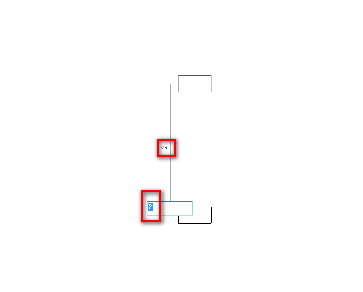

i am trying to adapt the revit family Ladder to make a stud wall where rungs and stud have similar parameters
but
the "number of rungs" label is snagging me,how  do incoperate it in a 3d model
load family into generic model restricts import-excludes annotation label?
see clip for explanation
http://www.youtube.com/watch?v=qri7zaH02x8
shared parameters?
Sun, Jul 4, 2010 at 8:42:50 AM | import label anootation to generic 3d model
Joined: Tue, May 22, 2007
5921 Posts
4 Stars: 205 Votes
That "number of rungs" is the parameter from the "Array, after you create the array, select one element then select the line with the number (2), in the options bar select "Label / Add parameter", then give it a name (number of rungs), and a group parameter like you can see in the images.

Mon, Jul 5, 2010 at 5:26:19 AM | import label anootation to generic 3d model
5921 Posts
4 Stars: 205 Votes
No need that, you must SELECT the LINE of the array and not the number, watch this: http://screencast.com/t/NzFkYTlm
