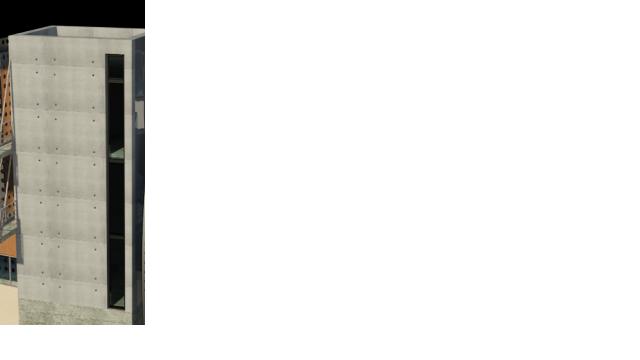

Hi people, I need your help, I need to create a Wall Family or modify one Wall Family to create this model (see photo attach), can any of you already do this type of wall?
 Please help me!!
Thanks
Wed, Jan 7, 2009 at 8:43:45 AM | Concrete Wall
This appears to be just a cast-in-place (maybe it's precast) concrete wall that has form and form tie marks.  If you want the color variation, you will have to find a jpeg that will give you this.  The holes at the form-tie points could be simple voids.

Yes, but how can I create this type of wall, because when I do the render I have a continuos wall, and I want to see the lines and the holes of the individual panels.....
Wed, Jan 7, 2009 at 9:58:31 AM | Concrete Wall
As I wrote ... add the holes as voids.  The lines might be very shallow reveal sweeps but that is not what they are in real life.  If you could get a jpeg large enough to include the "lines" that would be better but I doubt you can.

If the wall is a precast concrete panel I have created that using the Curtain Wall tool. I change the panel to concrete and adjust the curtain grid to match the panel size. The little void parts would have to either be built in to the "Panel" or added as a wall based element.

This is one wall out of a much larger project. I didn't have the need for the little form tie points but that would be easy to add.

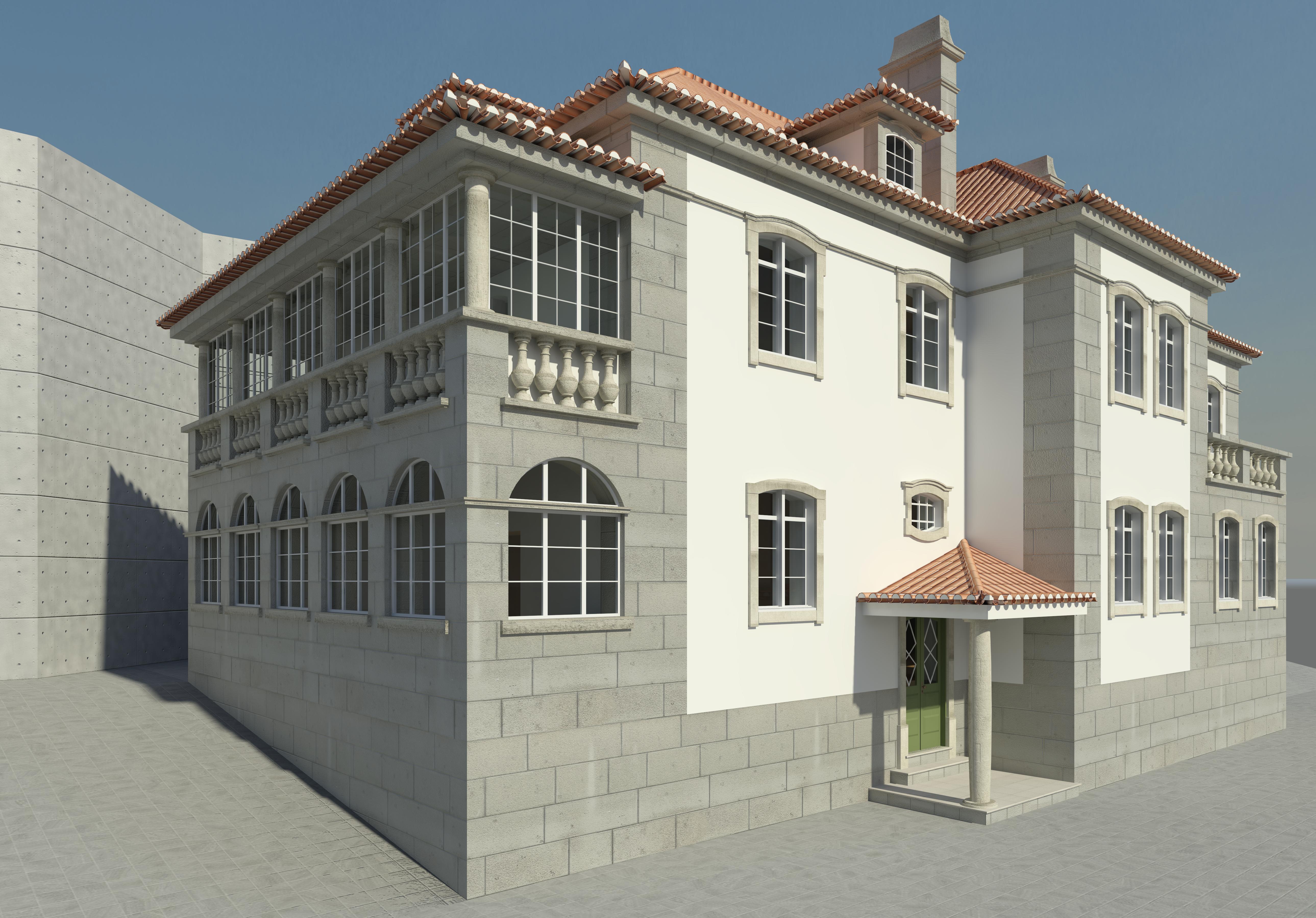

Check in the image i post the wall beging the house, it's only Texture, not voids or reveals...

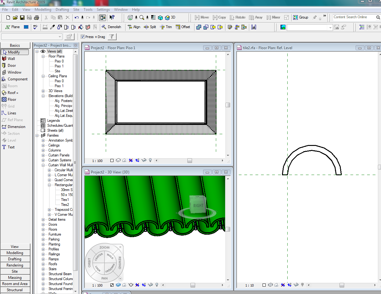

I have a question, can you explain me how can I put tiles in my generic roof??, can you please post some example file??
Wed, Jan 14, 2009 at 3:42:19 PM | Concrete Wall
#13
Joined: Tue, May 22, 2007
5921 Posts
4 Stars: 205 Votes
Hi, see the video: http://screencast.com/t/22w0Ku2I4Fw

wooooooo men you are rock......... and what happen if I want to create this type of tiles roof... see the attach file
 See, one up one dow, one up one dow, one up, one down, in the video that you post, you only have up tiles, I want combined up and down tiles.
Thanks bro...
Wed, Jan 14, 2009 at 4:42:37 PM | Concrete Wall
#15
5921 Posts
4 Stars: 205 Votes
It's very simple, create 2 Roofs, remember to duplicate and give different names (Roof1 and Roof2), then in Roof one do it like the video i post, then in the roof 2 create the new profile (like in the image i attached) and repeat the process but use the new profile....
