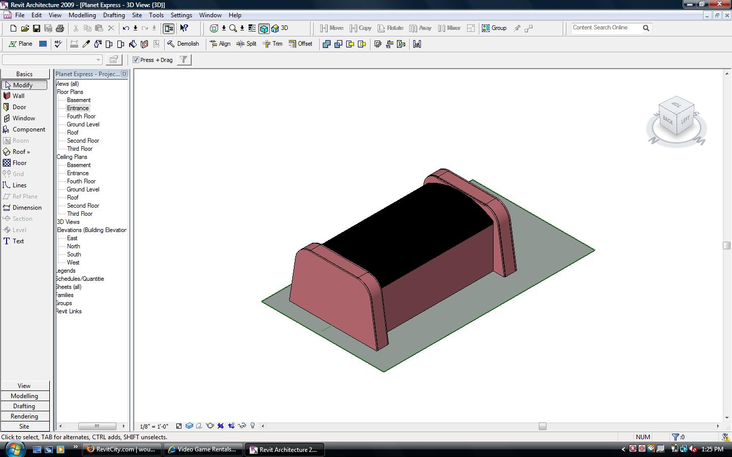

I was thinking that you should make a mass form and then do wall by face.  then you could get a curvature and slope to the sections of the wall on the lower part of the tower.

ok, i already used the massing feature for the hangar ends, the outcroping. i used the sweep featuer. heres a pic.

This is awesome!  Can't wait to see it finished.  For the top circular part of the tower I would go to the Modeling Tab - Create/Solid Form/Solid Blend and create to half circles.  Then put the two half  circles together to create the large circular ball shape on the top part of the tower.
