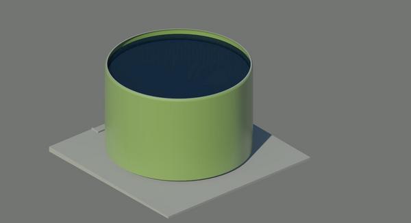

Parametric Water Tank with Parametric water inside. I tried to work out the water and tank volume calculations but gave up when I relaized that I and Revit can't do math very well

Revit does math just fine, except for the tank volume removed by the curved top.  By the way, in the downloaded version, the water is not visible.  Copy/Paste the equations below into the formula sections for the desired result.
(3.14159 * (Water Radius * Water Radius)) * Water Level
(3.14159 * (Tank Radius * Tank Radius)) * Tank Height
