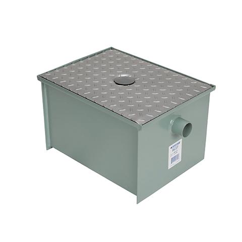

MIFAB® MI-G  - HYDRO MECHANICAL GREASE INTERCEPTOR
MIFAB Series MI-G ____ sanitary, acid-resistant, powder epoxy coated inside and outside fabricated 10 gauge steel hydro mechanical grease interceptor with flow rating of ____ (indicate) and grease holding capacity of ____ (indicate). Unit shall include:
removable baffle assembly and cross bar, deep seal trap covered by lid, sewer gas stopper, securing bolt(s), external vented flow control fitting, internal air relief by pass, feet underneath interceptor to elevate it ½” off the ground, and steel acid resistant, powder epoxy coated, non skid, rectangular gasketed lid(s). Interceptor shall be tested and certified to the P.D.I. Standard PDI-G101 and A.S.M.E. A112.14.3 and be so marked.
