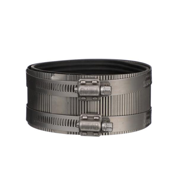

MIFAB® Series MI-HUB (specify size) shielded no hub couplings are manufactured with gaskets made with neoprene that meets the requirements of ASTM C-564 housed inside a Type 301 stainless steel corrugated shield. Two (2” through 4” size), four (6” through 10” size) or six (12” sizes) Type 301 stainless steel clamps tightened with 5/16” Type 305 stainless steel hex head screws surround the shield to provide the sealing force. MI-HUB Series Couplings are tested and certified to the ASTM-C1277-2018, CISPI 310-2010, CSA B602-2010 (File # 247608) and B70 Standards. They are listed with IAPMO and NSF certified CISPI 310. Also tested and certified by Intertek Testing Services to CAN/ULC S102.2-07 “Smoke Test.”
