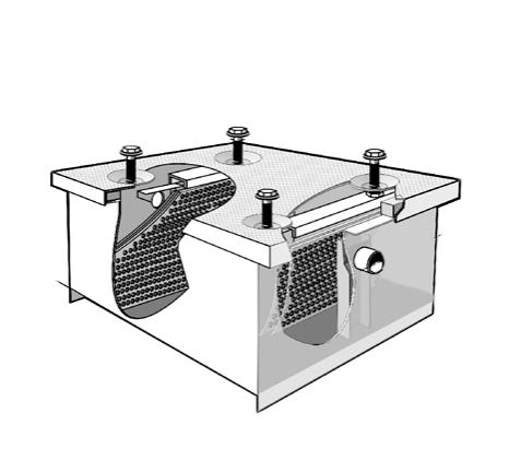

MIFAB Series MI-RICE sanitary powder epoxy coated inside and outside fabricated 10 gauge steel rice interceptor with flow rate of _____(indicate). Unit shall include: ½”(13) thick fixed primary straining baffle with 1/4” (6.4) holes and secondary ½”(13) thick removable straining baffle with 1/4” (6.4) holes, removable cross bar , securing bolt(s), stainless steel calibrated orfice plate, and steel powder epoxy coated non skid rectangular gasketed lid(s).
