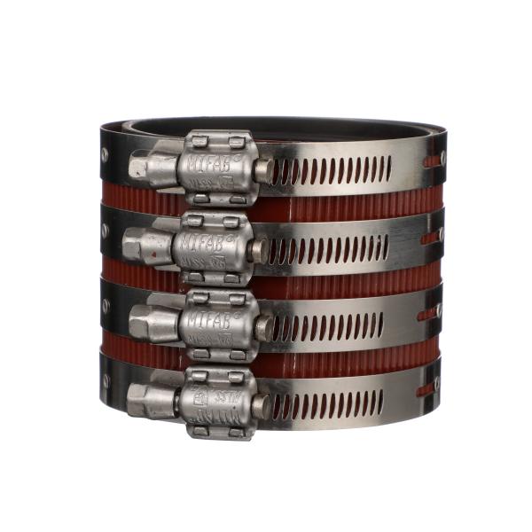

MIFAB® Series MI-XHUB (specify size) heavy duty shielded no hub couplings are manufactured with gaskets made from neoprene that meets the requirements of ASTM C564 housed inside a Type 304 stainless steel corrugated shield. Four (2” through 4” size), six (5” through 15” size) Type 304 stainless steel clamps tightened with 3/8” Type 305 stainless steel hex head screws surround the shield to
provide the sealing force.
MI- XHUB Series Couplings are tested and certified to the ASTM-C1540 and CSA B602 Standards and are listed with IAPMO. The MI-XHUB are also tested and certified by Intertek Testing Services to the CAN/ULC S102.2 “Smoke Test”. The MI-XHUB are tested by IAPMO to comply to the FM1680 Standard (except for markings).
