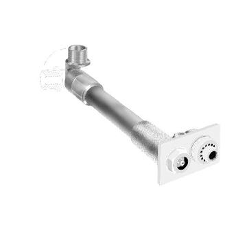

MIFAB® MHY-15 - LOW LEAD NON FREEZE WALL HYDRANT
MIFAB® Series MHY-15 _____ (specify length) A.S.S.E. 1019-B certified exposed type, self draining, low lead, non freeze wall hydrant with A.S.S.E. 1011 approved anti-siphon and vandal resistant integral vacuum breaker with 3/4” (19) male hose connection. Hydrant assembly complete
with neoprene plunger to control both the flow and drain functions, hardened bronze operating stem, drain port under the hexagon nut, heavy duty brass casing, 360 degree swivel inlet connection, heavy duty chrome plated bronze head casting and polished chrome plated face plate. Operating key to be furnished with each hydrant.
