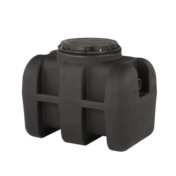

MIFAB® Series BIG- ___ -S HDPE rotational molded solids interceptor with solids holding capacity of ____ (indicate). Unit shall include: 3/8” uniform wall thickness, solids retention baffle with elevated 3” diameter passageway, adjustable lid system, sample port access and 4” no hub inlet and outlet connections. Steel encased composite lid provides a water / gas tight seal and has a minimum of 20,000 lbs. load capacity. The lid is designed in accordance with the loading requirements of AASHTO H20.
